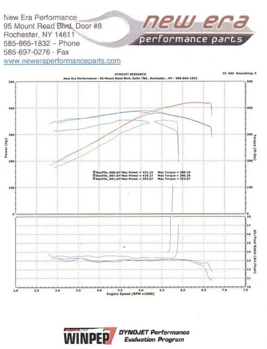

Here is something i stumbled across. Another thing to keep in mind is that the 5.0/stroker combos can be impressive, but its not that "fair" to keep one car limited and another car fully modded. Unless u make it so u pick one car or another with a certain budget, there are going to be tons of modded LS1's out there....with as much "work" into them as the 347s. So it is good to see how much ground can be made up with out "smaller and older" parts, but at the end of the day, to be realistic, you gotta let each car have whichever mods "usually" pop up on them and go from there. Especially when comparing 347's to LS1s. I know if i had a LS1 and i had a 347 driver talkin trash to me, i would either be thinking or saying to myself, "wait until i upgrade heads". I couldnt care less that u had a iron POS stock and i had a decent aluminum head stock. To me you spent $2000+ on heads and i spent $0 and you might not be making more than me. Now let me spend $2000 on heads and we'll see where the pieces fall.
Yea.....the Trans am has been my favorite since they came out in 98 :lol:
My car went to New Era Performance for a cam swap on monday and picked it up today. The car was dyno'd with just bolt ons before the cam swap. Mods were: Edelbrock Stepped LT's, ORY, Hooker catback, SLP lid + underdrive pulley, Ported TB, Fernco mod, LS6 intake, TR55 plugs, PCMforless tune, cutout, K&N filter, TB coolant bypass, 7.400" Manley pushrods, Comp 918 springs, Moser 9" rear(spool), MT DR's on 17" Z06 motorsports.
Bolt on results w/cutout closed: 353.67rwhp/354.07rwtq(SAE)
After this was done they did a cam swap, oil pump, double roller timing set, spring upgrade for me. I chose a custom cam from BRE(Bret Bauer). Specs won't be given but its a small cam, around the size of F13, G5X2, TSP torquer, etc. My concern was good driveability, torquey, fun cam that could be daily driven if need be, oh and around 400rwhp. Oil pump was LS6 unit. Springs were upgraded to PAC springs 1518, which is similar to the Comp 918's(beehive spring, but its nitrided and some other stuff....same seat/open pressure, coil bind, but good to .650 lift.) Also injectors were swapped out to factory 28lbers, since duty cycle was high with the 26's. Spark plug wires were also swapped to MSD's since some of my wires ripped when taking them off. Tuning was also done by Mike@ New Era.
Cam-Only results w/ cutout closed: 419.27rwhp/386.28rwtq(SAE)
....................... w/ cutout open: 421.15rwhp/389.18rwtq (SAE)
Picked the car up today and the cam drives like stock, with a whole lot more power. Drive home was 3+ hours and was very pleasant. I am very happy with this cam, Bret really came through with an awesome cam for me. Also it was a pleasure to work with New Era performance, communication was super with them, even being 200+ miles away. They went out of there way to take care of me and to make me happy, customer service is great. Mike Tuned this car flawlessly, and it literally drives like stock w/ just a hint of cam surge in 6th gear at around 1200rpm's...but very livable. I will be a return customer there. Big Thanks to Bret, and all the guys at New Era for a job well done. I should be hitting the track soon to get some baseline numbers before I start doing suspension work.
Look at post #16 for a quick sound clip. This is with the cutout closed through the hooker catback.

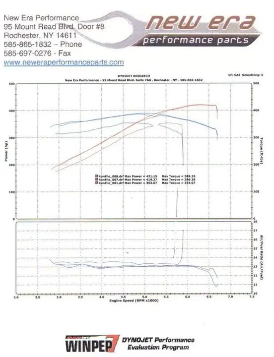

Colonel09-18-2003, 04:36 PM
That was a pickup of 71.6 RWHP at the peaks and alot more than that in other places (after the stock cam's peak.) Not bad for an A4 car with a cam that prompted me to accuse them of reinstalling the stock cam in my car when I first heard it (we left the idle where I had it with the stock cam at 675 RPM.) :nod:
For those of you who may think that a 116 LSA cam can't make TQ, this cam absolutely KILLED the stock cam all the way across the chart. It made 395 ft-lbs of TQ with a locked converter. The stock TQ was 360.
Here are some more details.
The car has the standard bolt-ons including QTP 1 3/4" headers. No bolt-ons were added with the heads/cam package.
The 422 RWHP was made through the QTP cuttout. With the cuttout closed and running through the stock exhaust it made 395.5 RWHP. The stock muffler is REALLY restrictive at this power level and the reverse split seems to really like the cuttout.
All runs were made with ALL original accessories intact. NO short belt. NO electric water pump. The air filter WAS in place. The converter was locked. The stock rockers and lifters were re-used.
Cam specs are 224/220 .581/.581 116 LSA
