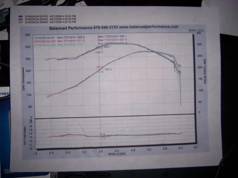

The explorer intake is holding me back a little, but she is fast and strong!! I made 293tq at only 3500 rpm!!
I dynoed at 271 hp and 307 tq at 12* timing. The guy said if I wanted to up the timing he would have to charge me by the hour instead of the 69 bucks for 3 baseline pulls, he even threw in free Air/fuel and it was perfectly flat at 12.7-12.9 all he way to 6250!!
I think I can up the timing to like 17-18 and still not gonna ping so I think I will try to mess with it and look for SOTP feel.
Driveability is much better with the 24#ers too!

Dyno sheets and a few other vids
