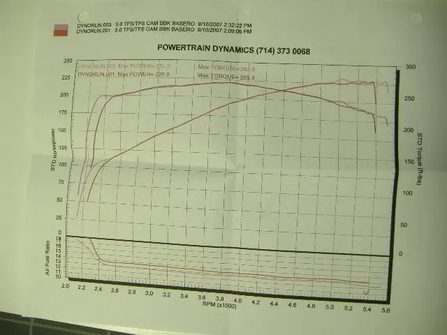

Well I'll start off and say, Though the numbers displayed here are not awe inspiring, they are not exactly bad. Here is the combo
Rebuilt long block (.030) with Gt40p heads (no porting)
Trickflow (TFS) stage 1 cam with stock (non roller) rocker arms/springs
Trickflow street heat intake
Mac cold air intake
Underdrive pullies
BBK shorty headers
Stock (read: very restrictive) 4 cat (california nazis) H pipe
Smog pump still hookedup
AODE
Dyno tune (with some flaws still to be worked out)
Stock MAF/injectors
The 4 cat h-pipe and aode are deffinatly working against larger numbers here. But this is a daily driver and the Torque curve is pretty sweet. The temps at the time of the Dyno run were in the mid 80's maybe low 90's , this is at sea level.
What do you guys think? should the dyno tune resulted in more power from this combo?
The A/f ratio was in the mid 12's on the best run of 231.2 hp and 265.8 tq.
Am i seeing vavle float at the end of the run near 5,500rpm?

Those numbers still seem really low...Paul or Gcomfx dynoed his car with almost the exact same setup as mine with stock heads and cam and put down 239rwhp. Even with cats and AODE i would have thought you would be in 255range and without cats maybe around 265-270ish.
I bet the stock cats are KILLING you. Got a lot of miles on that pipe? How about the factory catback, is that still on?
While it is lower than I would have thought it is not all bad since you have the AODE.
Let's see what others have to say but I wouldn't have expected too much more...
Looks about right to me.
A tune will wake it up and shake out about 10 rw. You could try retarding that cam a couple degrees to help you out on the top end. It's time to step up to 24lb injectors but the stock MAF will still serve you fine.
I know what valve float is but I don't feel comfortable enough to diagnose it so I'll leave that for someone else.

This currently is the only print out i have. I most likely will be going back after i pass smog and put the other *ehem* H-pipe back on. He also mentioned i should replace the o2 sensors. So we will see what that nets me hp wise.
The stock stamped rockers are garbage as well, with that cam, and those heads you are doing no justice by having non roller. Those numbers look just about right to me, a couple more things will wake it up considerably. I would do the following:
1. put your other h pipe back on. 2. 24# injectors. 3. roller tip roller rockers. 4. get a little head work done, by head work I mean new valves springs retainers etc (this is not absolutly needed but if your getting float this will stop that) and If you can afford it, a nice port. This should put you right about 260+ hp and over 300tq. I got 263 hp, and 305tq on my cobra when it had stock heads, and a e303 cam, with a few other goodies that you already have.

The results seem in the ball park to me :)
I'd upgrade the mid pipe as the OEM pipe is very restrictive
You need more fuel :Word:
I'd do in tank pump, inj, & meter
Yes the OEM rockers are kinda clunky :(

Steve Tuned chiped/tuned it to make it run a little more nicely with the cam. The computer just didnt like the cam at idle at all!
I see quite a few you saying the 19lb injectors are starving it, but the AFR is in the 12's, so am i missing something? I've read the air meter is good to ~ 300rwhp along with the throttlebody.
The roller rockers would be *neat* but i dont see them netting anything exceptional except abit more vavletrain noise.
I figured these numbers are unique as i havent been able to find any gt40p /AODE numbers posted, yet.
One thing to note about roller rockers is that you can rev the engine a little higher. I noticed a good difference at the track with roller rockers. Of course I also went with a higher ratio rocker which affected the overall lift of the valves. But, a smoother running valvetrain will net more power due to efficiency of the roller versus slider type fulcrum.

Your dyno numbers are about what I'd expect with your combo, and are not bad when you consider that the drivetrain HP/TQ loss in an AODE GT is about 22-24% (it's only ~13% in a 5-speed manual). You could do better though.
As you already know, the stock catted H-pipe and sloppy-shifting AODE are hurting performance, so you could do yourself a favor by installing a performance catted H-pipe and rebuild the AOD with a shift kit. If you don't already have a 3.73:1 ring & pinion, do it 'cause you'll love the result.
The stock valve springs are pretty sturdy and your dyno curves don't nosedive at the top end (the dip at 5400-5500rpm is the tranny shifting up) so I don't think there's any valve float. The wavy line from 5000rpm upwards is more likely to be from a small ignition misfire; maybe the plug gaps are too big.
