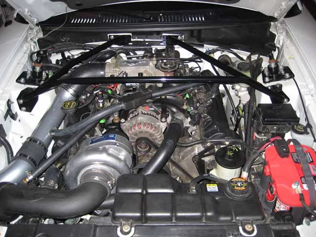

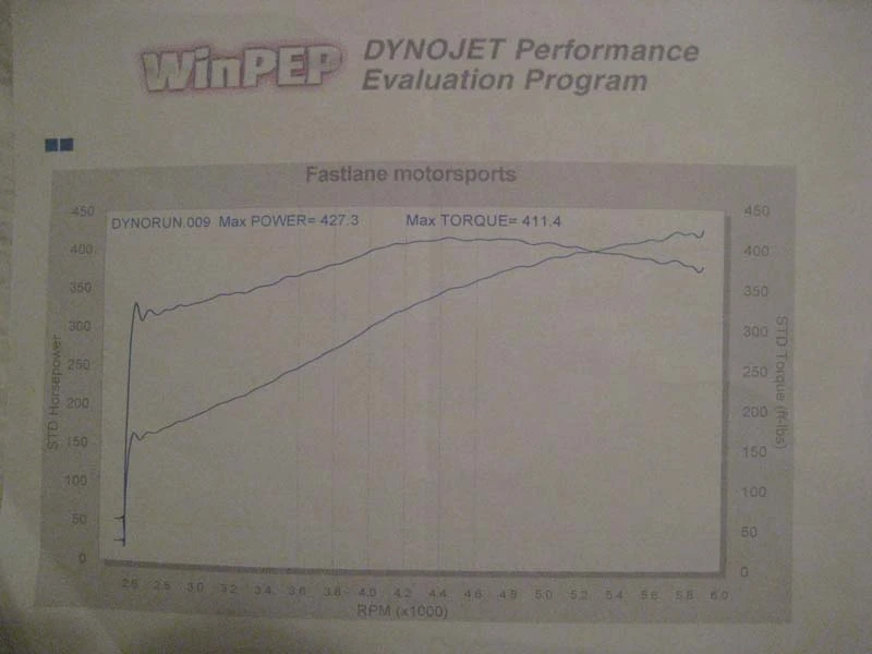

So I came home stateside on R&R and got to drive her for a little bit. My sig should have most of what I've done so far far and I am more than happy. Most of the work was done by myself all except the supercharger my Wife had that installed and dyno tuned by Fastlane Motorsports before I came home and they did a great job Defenetly alot of power and it's still more than drivable. Went from North Carolina to Connecticut and got around 26 MPG most of the way until I hit the northeast and their garbage gasoline then it dropped to around 23 MPG (another of the many reasons to never move back to up North). Didn't have enough time to put the brakes and other stuff in I'll do that on my next visit to the States

Do you have long tube headers?

The only mods in the engine other than the supercharger kit is a flowmaster cat back and everything else is bone stock

Those are good numbers for an otherwise stock engine! My husbands car is also a stocker engine with a P1sc. He makes 425 HP ands 430 TQ. You can tell it doesn't want anymore boost, or else boom! We already did one forged long block for my car this year. I keep telling him he has to wait until next year to blow his up! Congrats, and enjoy!

what size pully are you making those numbers with? how much boost?

3.60 gives me 10 PSI of boost.
