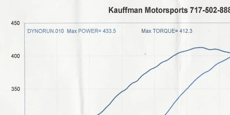

dyno pics...let me know what ya think
neoboss589
Jun 25, 2003
25
hershey,PA
Here are my dyno sheets from 2 weeks ago.this setup i have is pushing about 12-14psi through a 90mm maf and 42lb injectors.The bottom end is stock, and was told i cant go above 450hp because of the not-forged internals.If i get forged internals, i could go intercooled and change some other stuff(throttle body,etc)and i could be around 500hp.I just wanted to hear some of your opinions here before i make any decisions.
Here are the pics.
I had about 410 hp with my 99 running 12 psi before my pistons gave out. I installed the smaller pulley and power pipe then about 2 weeks later oil was running out of my exhaust. It took me a while to get caught up and be able to get another Mustang. I am not going there again until I forge up the bottom end. I suggest you get that stock pulley back on or you are headed for a rebuild.
