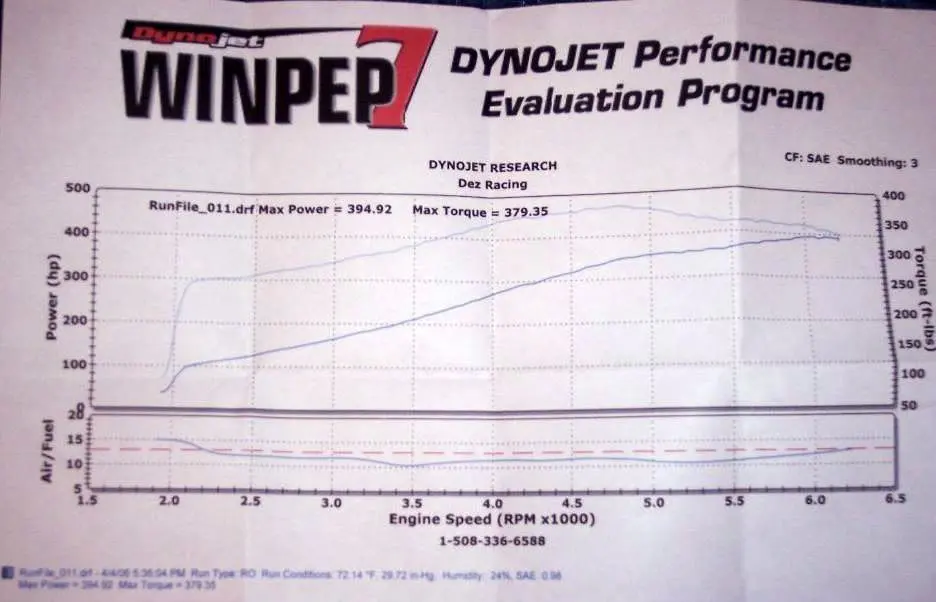

Dyno Results are in!!!! Everyone come in help
Mustang4119
May 26, 2004
162
He was trying to suck fuel out in the curves where you see its kind of lean. How do you make the line go straight? If mine was straight, would I see more power? I was at 13lbs of boost. He said the dyno is about 10rwhp off so I have about 404rwhp, i dont know. Are these good results? Shouldnt my torque be higher than my hp usually?
"He was trying to suck fuel out in the curves where you see its kind of lean..."
Are you serious, If so Id take it to another tuner, that cat needs more fuel, not less
At your power level your hp will be higher than torque too.
