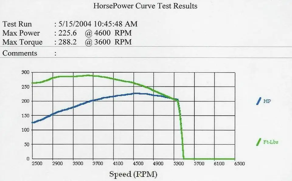

Took advantage of a local shops open house to get baseline numbers before i install my HCI during winter. i think numbers are just about right. car has been a blast to drive recently.
Made:
223.8 HP and 279.8 TQ
Mods:
Stock 302 101k miles
Cobra intake
underdrive pullies
mass air conversion with stock sensor
70mm BBk TB
ford racing shorties
Stock H-pipe
Bassani catback
Vid:

Seems a little bit low, but when I baselined my I made a little higher #'s than you (my engine only had 43k though). I would have thought you would be higher for having a 70 mm TB and Cobra Intake but I can see your stang pulled higher in the higher rpms compared to mine.
Mods at the time were:
Longtube headers
2-1/4" Catback and H-Pipe
BBK Pulleys
Stock Speed Density
Just curious what type of dyno did you use?
Oh and I did built a new engine and let me tell its a world of difference! What HCI are you planning?
Soontobefastfox thanks for the reply and comparison. The pulls were done on a DynoJet. I think that ttop88 is right. SD cars stock dyno'ed higher than mass air cars. The tuner at the shop estimated that with a larger mass sensor and an o/r h the car would be in the mid to high 230's.
The Trick Flow Street top end kit is sitting in my room just waiting to be installed. Thanks for the comments.
