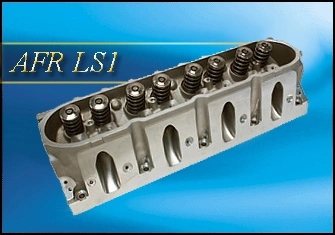

I disagree with this statement. The LS heads are a completely different design from the Ford heads. Have you ever seen the two next to each other?
By the way, anyone notice that the new AFR 225/205/185 Ford heads switched to an LS valvetrain?
The AFR 165's have gotten the "treatment" as well.
8mm's are lighter and obviously have a thinner diameter. Who knows? They may even have the slightest of edges in flow...
The ls1 heads are a tall port design, and even have offset head bolt mounting locations. Different valve sizes, which the ls1 is even smaller at 2.02", not 2.08" like the Ford version.
Airflow Chart for Track AFR 205 Heads:
Lift Value (in.) - Intake Flow - Exhaust Flow
Inches - CFM - CFM
0.200 - 141 - 125
0.300 - 201 - 180
0.400 - 251 - 211
0.500 - 291 - 225
0.550 - 301 - 228
0.600 - 306 - 231
0.700 - 310 - 235
Tests conducted at 28 in. of water (pressure)
Intake valve size 2.080 in./exhaust valve size 1.600 in.
Airflow Chart for LS1 Street AFR 205 Heads:
Inches - CFM - CFM
0.200 - 140 - 112
0.300 - 200 - 170
0.400 - 251 - 203
0.500 - 281 - 221
0.550 - 292 - 226
0.600 - 298 - 230
0.700 - XXX - XXX
Intake valve size 2.020 in./exhaust valve size 1.600 in.
The ls1 205cc actually flow less in every category, by a marginal amount.
Keep it mind, they are flowed on a slightly smaller bore, being 3.900" while the AFR 205's for Ford were flowed on a 4.125" bore!
The ls1 205's come with titanium retainers and 7* guides/locks, compared to the Ford version of steel/10* guides/locks.
