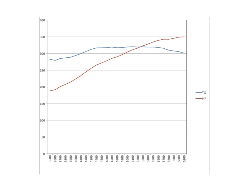

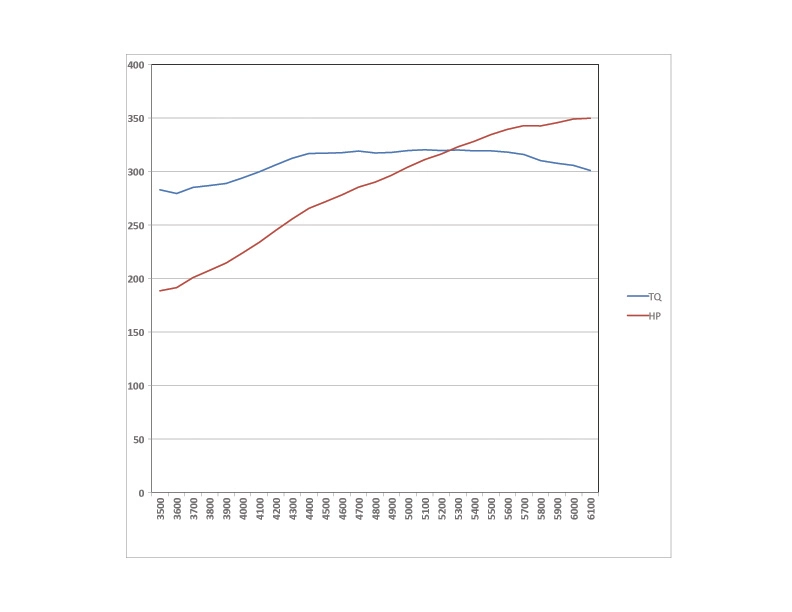

I dyno'd my rebuilt 289 (My brother built the motor) a while back but only just now was able to make it available for you all to see.
Let me know what you think of the results of my brothers work on a forty year old 289.

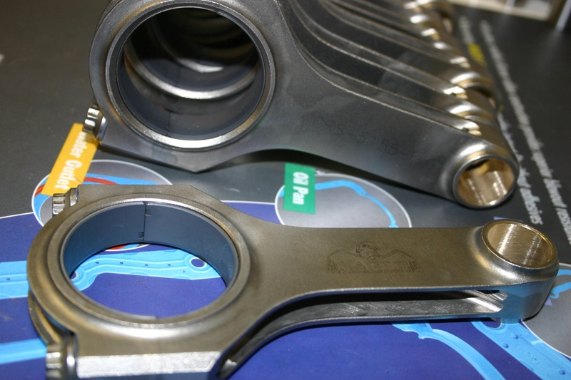

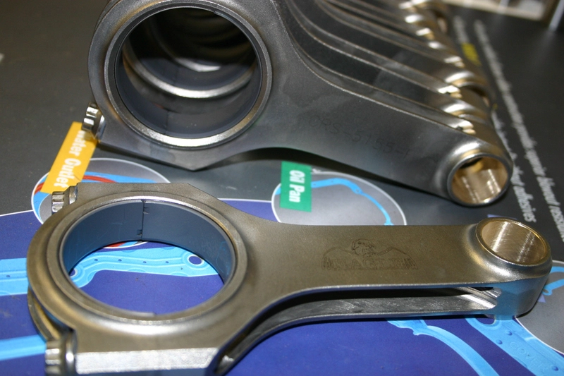

The Connecting Rods are stock length forged Eagle rods.

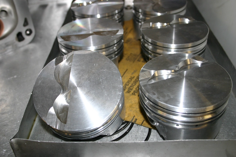

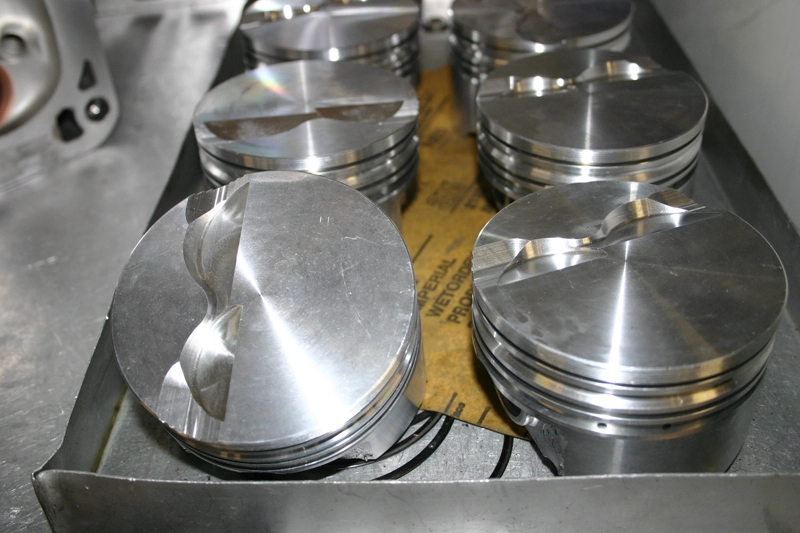

The Pistons I think are Hypertechnic(?). Which is supposed to be a cross between Forged and Cast. I guess you guess the benefits of both worlds light and strong.

bnickel said:
that has to be one of the flattest torque curves i've ever seen.
Thanks, my brother said the same thing.
coolblue65 said:
is that on an engine dyno or Rear wheel?
That's on an engine dyno. Lucky for me it's a straight drive (T5) so I don't think it's losing much going back. Either way it's a lot more then it had.

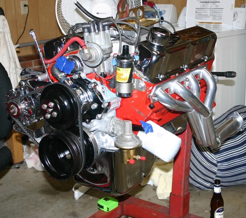

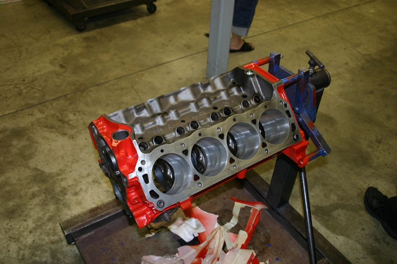

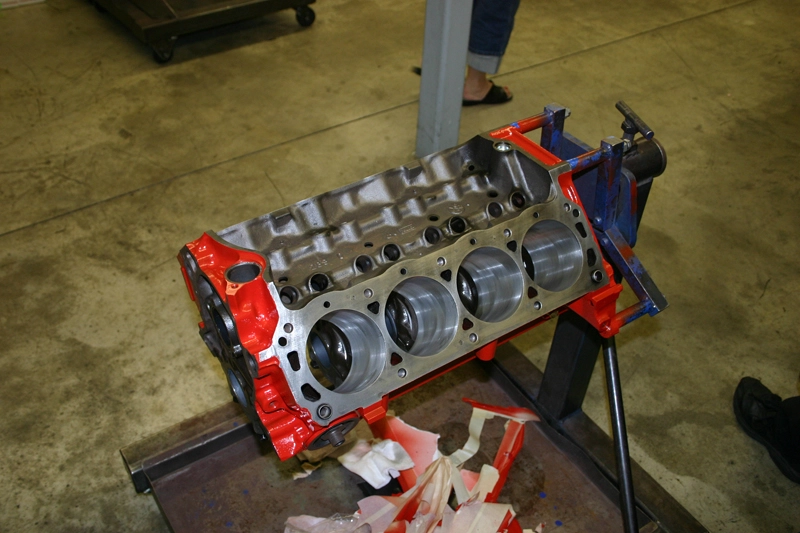

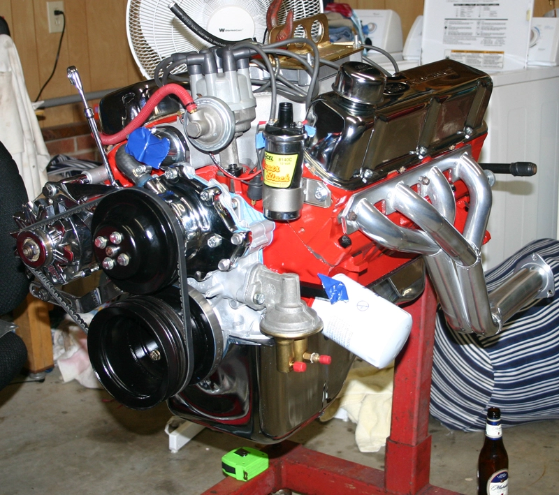

Here's some pics:
