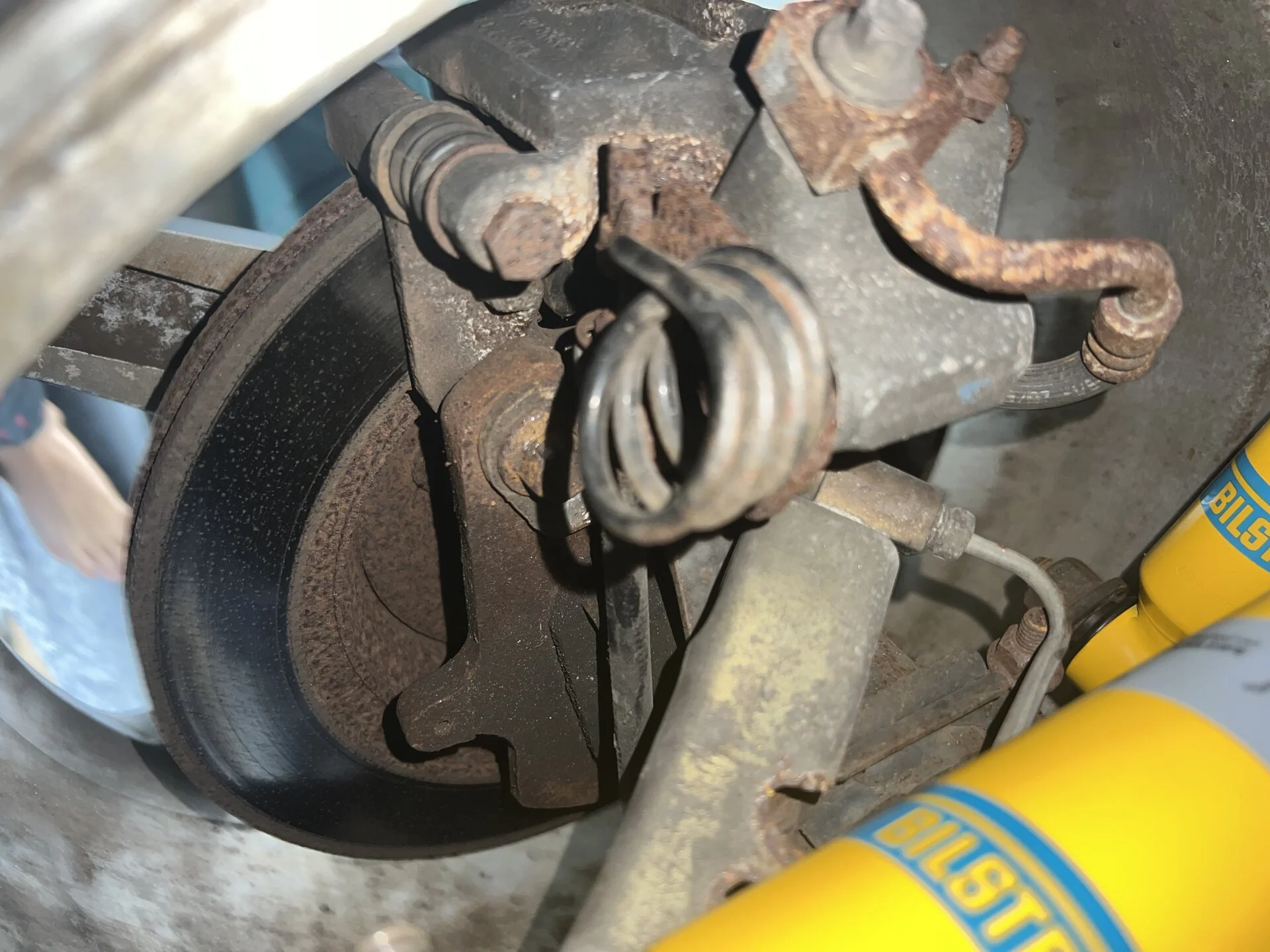

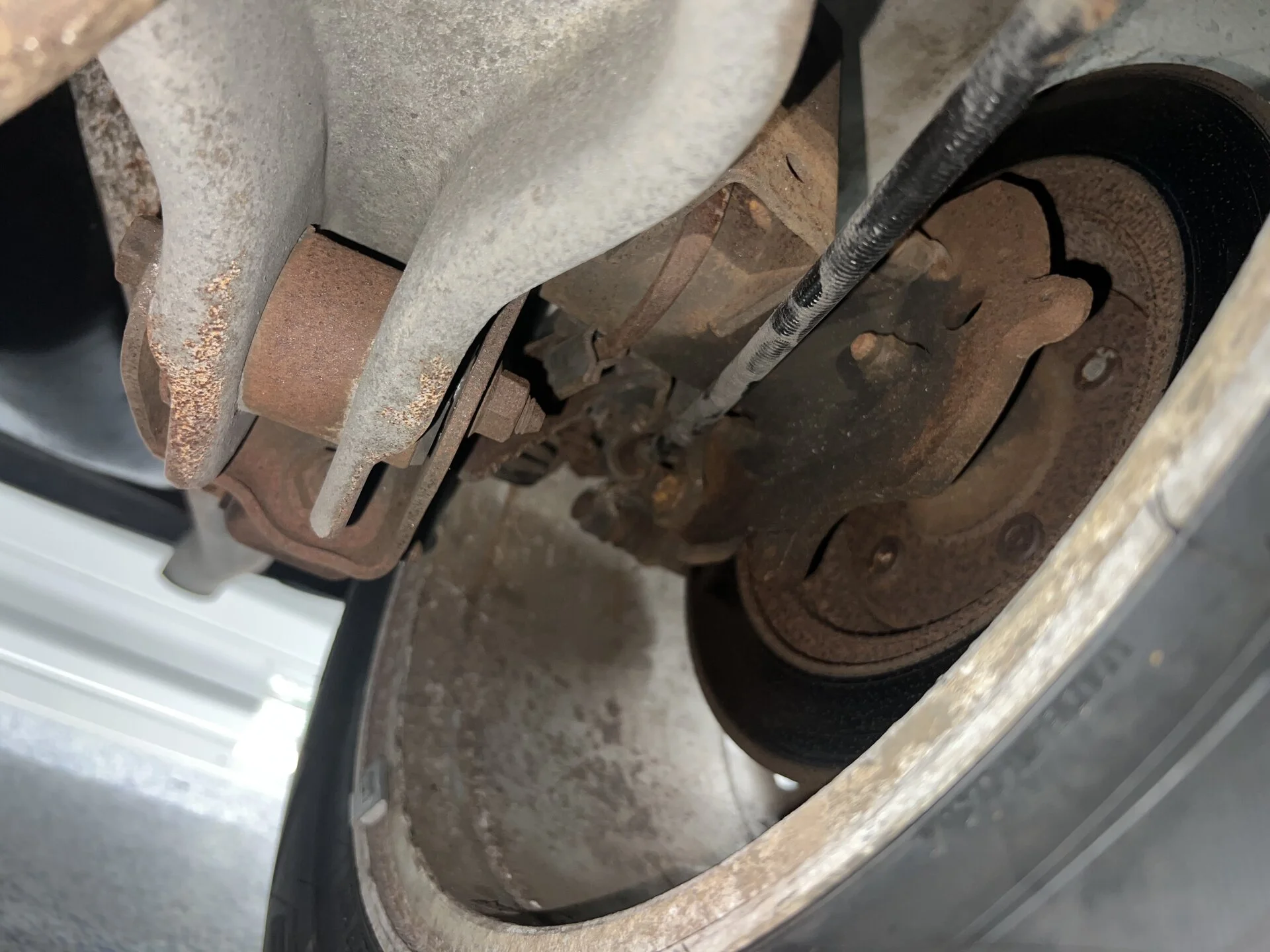

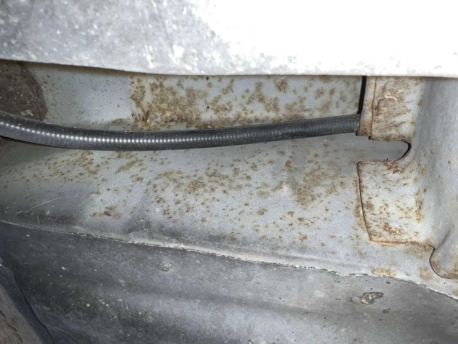

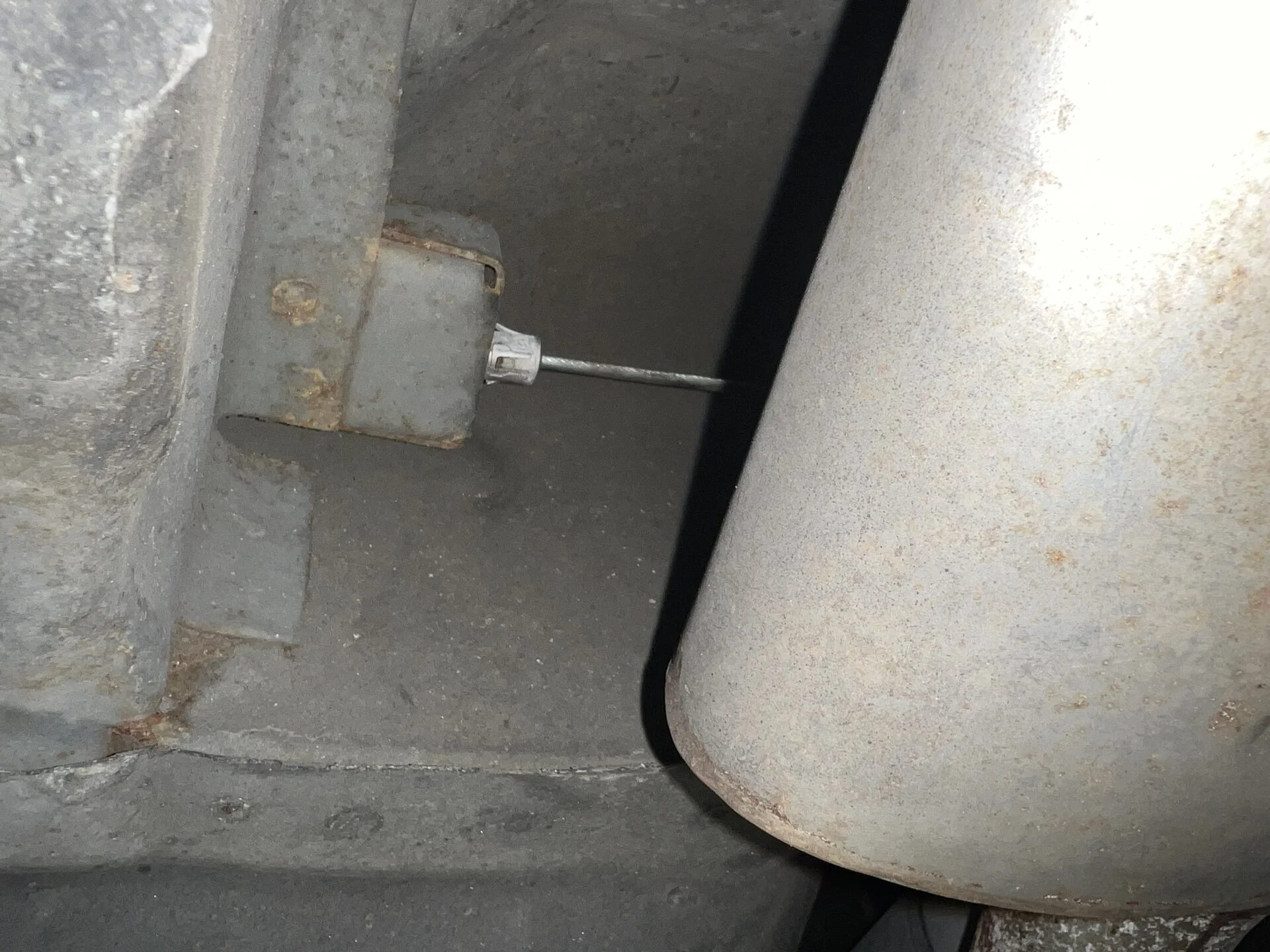

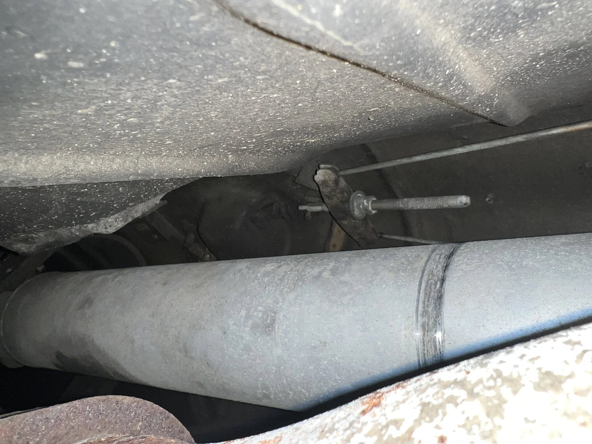

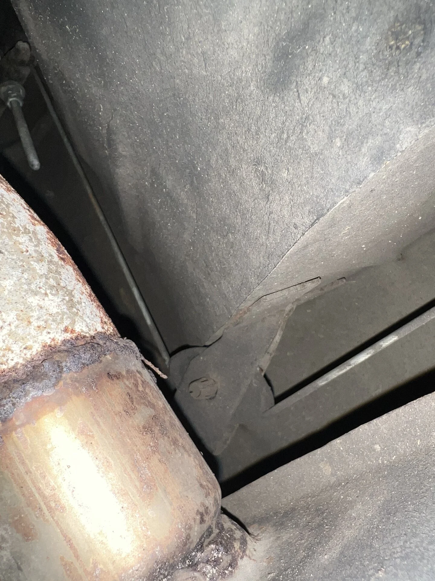

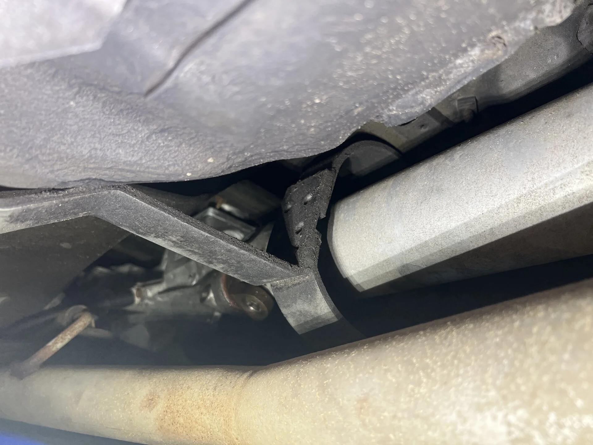

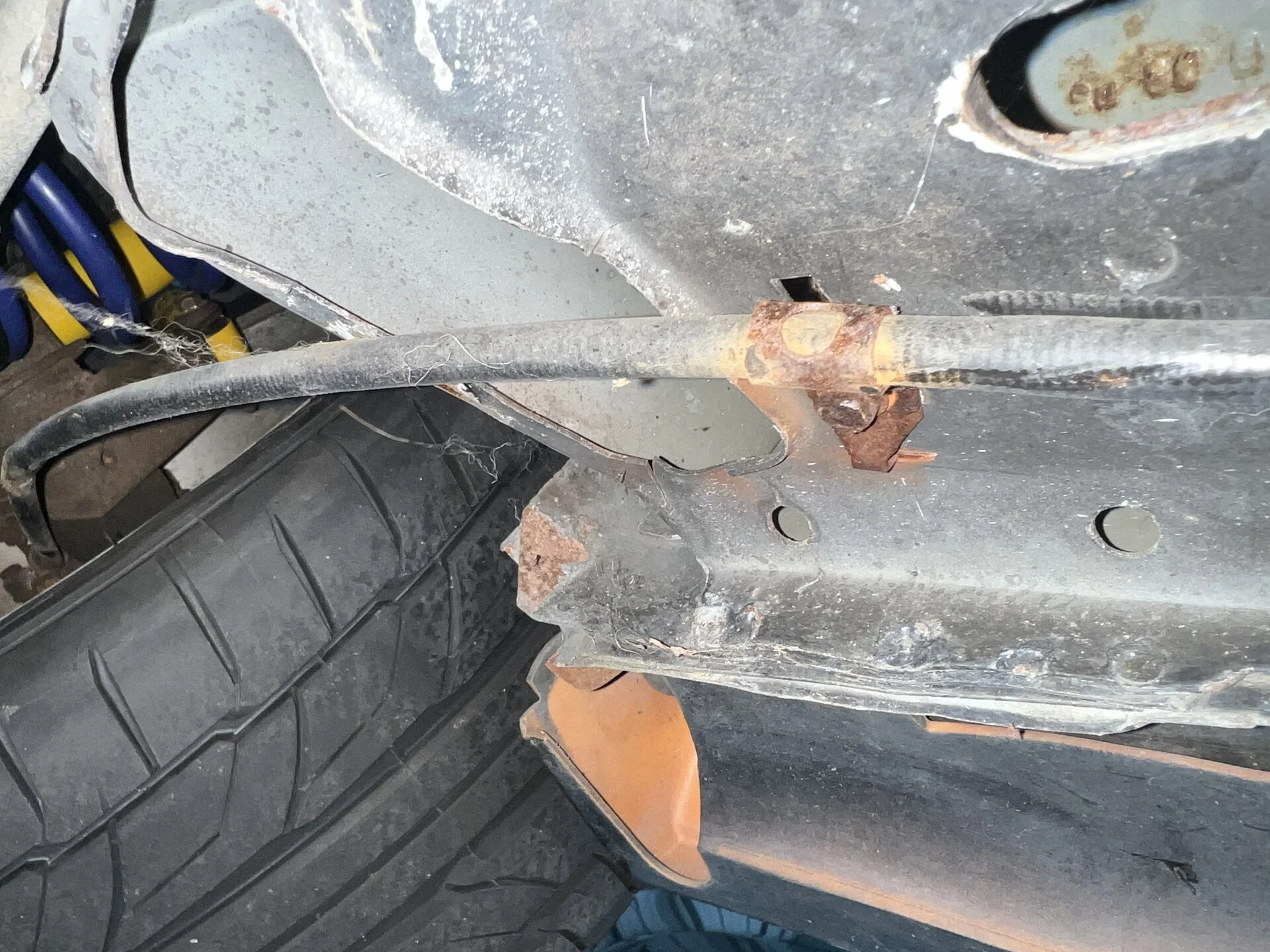

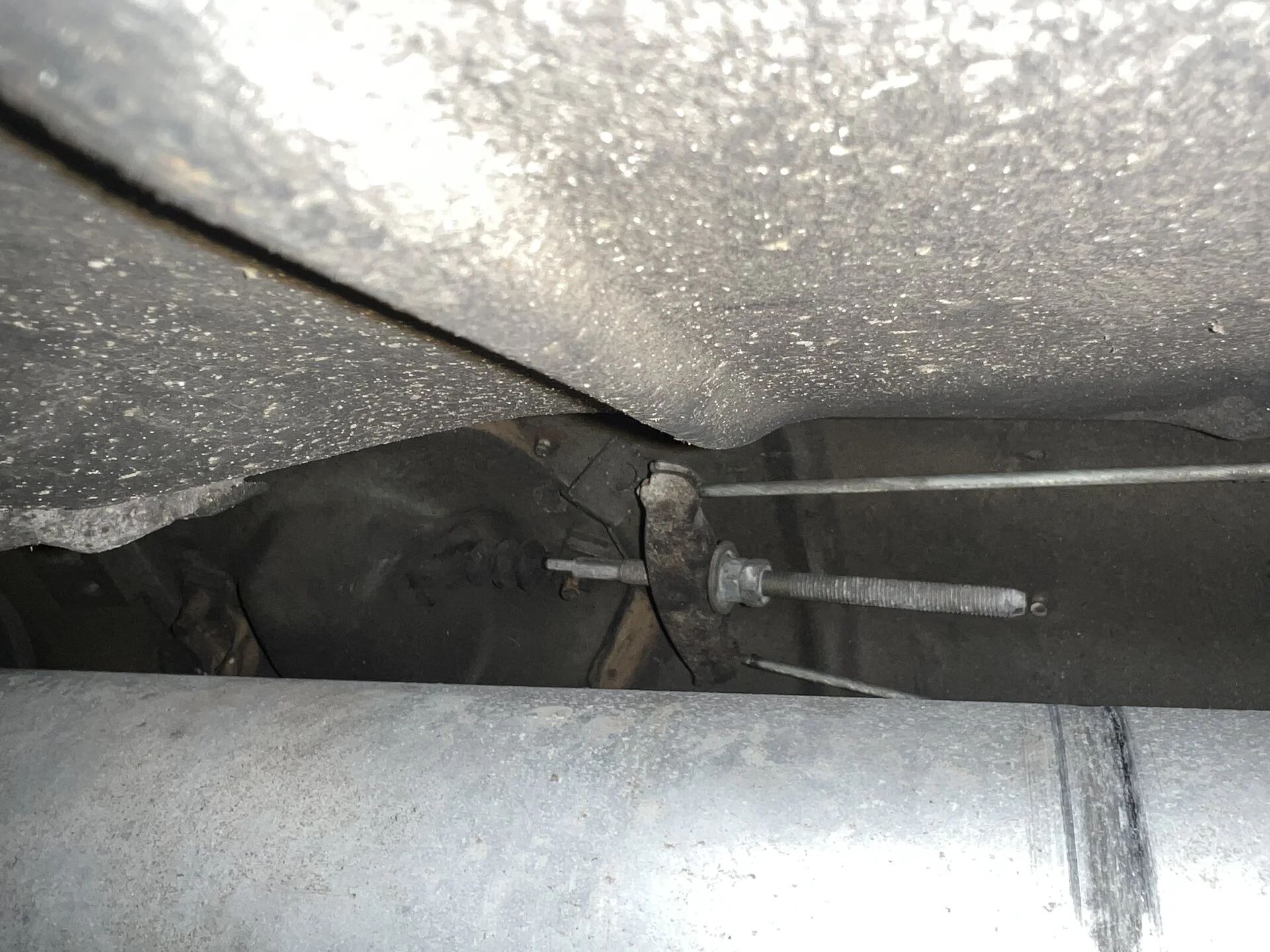

Here’s some pics from the back to front of the routing. Let me know what you think. I found the adjustment nut and it looks like it has some room for tightening so when I get the car off jack stands when I finish the suspension work I’m doing I’ll tighten it up and see what happens. Also, I just noticed this now, is that a aftermarket driveshaft cage I have or is that stock?

Its an aftermarket drive shaft Loop, looks like a Lakewood or transdepo from what I can see.
. I've found that with the welded 2nd tooth paw and adjustable center cable on pre 93 cars it really depends on what cables you us with the factory splinter since there's more slop. On my 90 coupe I never welded the paw or used an adjustable center cable, i just fabbed a 93 style tunnel bracket and I can lock the e brake any time I want, its been like that since the 90s when it had a turbo couple disc rear till now with sn95 brakes on it. My current 93 beater has the adjustable center cable , welded paw and maybe 4 yr old BC94497 cables on it, Its towards the top of the range but I can still lock the rear with it and haven't adjusted it since I set it up..
