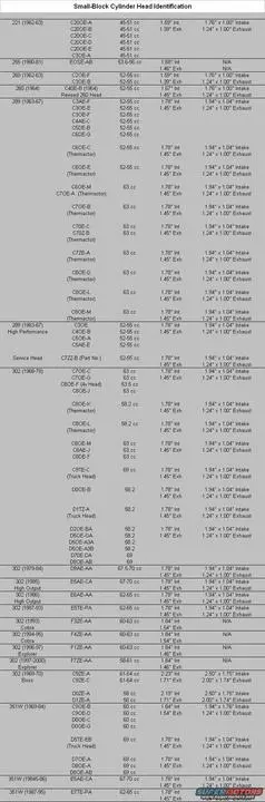

If getting a set of E7TE's is what you're after, don't bother with the ones you're talking about. If they've been rained on and have had the valve covers off for that long, they're probably in pretty rough shape. Not only that, but since they're on a Mustang, most people think that they're gold. Go scrounge a set off of an '87-up F-150 and you're going to get the EXACT same heads...right down to the valve springs!
Thanks for the tip! I may be back there soon, and I'll have to look for those. I was very close to spending Uncle Sam's refund check on a pair of junk heads. Seeing that the casting code was for a truck head, I was pretty sure I could score some from a truck, I just wasn't sure which one. Thank you very much!

Do you have permission to link to Supermotors.Org
Thing is, I'm sure they wouldn't mind if you at least put a link to their site or credited them somewhere.
Internet Theft, just because it's so easy it must be Ok, Right??
:rolleyes: If it's there for the general public to access, then it's fair game. If they didn't want you to have it, they'd stop you from hotlinking it....simple as that! Don't pull the high and mighty card and pretend you get expressed written permission and/or credit every site or piece of information you link.

somebody help me out here, please. Why are E7TE's preferred to other stock (cheap) heads? If I found a good set, will the old mustang II stock exhaust manifolds work, or will I need E7TE exhaust manifolds (or headers). If E7TE exhaust manifolds are necessary, how hard to install? thanx, mike
Mike, the GT40P heads used on the late model explorer are the best heads *Ford* ever made for the 5.0. However they had to move the spark plug location to do that therefore it requires special exhaust manifolds that won't fit our cars. The E7TE head is a good head for many reasons but most of all because it was the head Ford used over a period of time when the 5.0 in the Mustang was at its best (87-93). The head is common however if you have to spend a lot on any cast iron head then you're better off saving up a little more and getting aluminum heads. Due to their heat dissipation, aluminum heads generally allow the builder to run a one point higher compression ratio.
