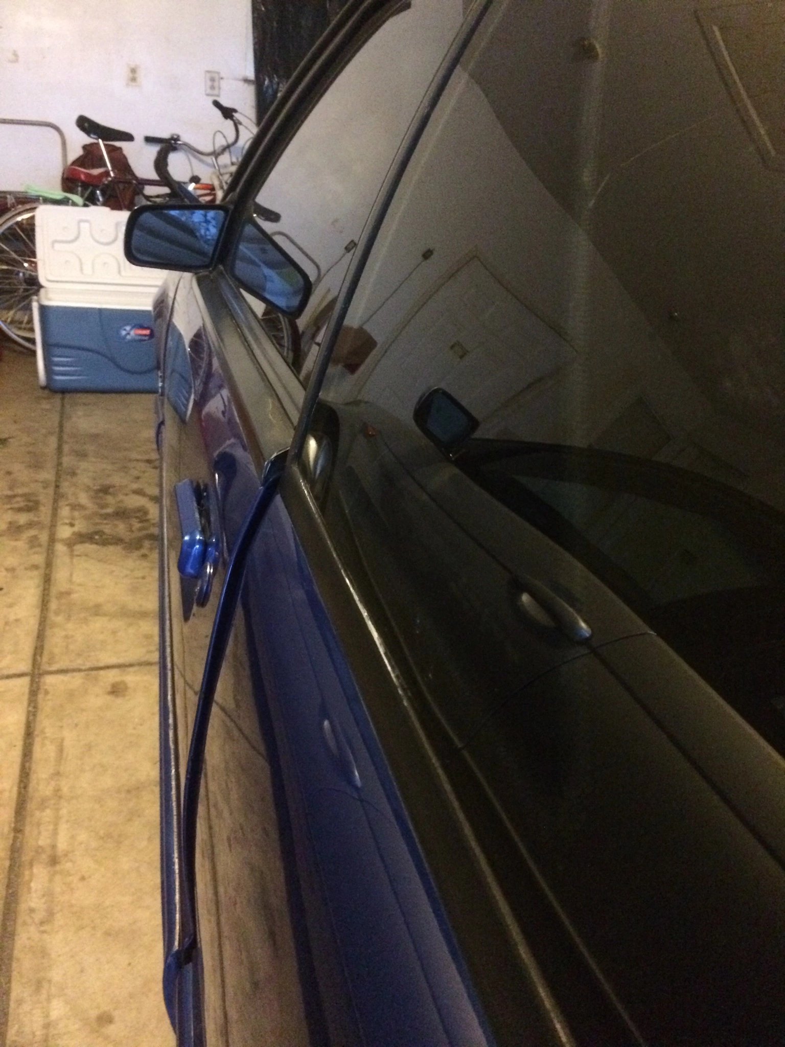

Nah, pins are good and door doesn't have up/down play. Replaced those when I swapped doors out on this car. Still can't get the striker positions quite right though. What's generally the correct location for these? If I close my doors softly they sit unaligned as shown above. If I close the doors harder the gap is taken up and the doors are quite tough to get out of from the inside. Also, my inside door handles have some play to them, will taking the door panels off and bending the rod in there take up that slack making egress easier?
