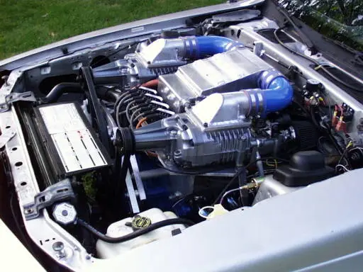

I have seen a lot of Eaton M-90 3.8 superchargers for sale on Ebay lately. I was considering putting one on my 95 GT Vert. I'm sure this little supercharger will not make a whole lot of power but it is very cheap to buy it. Anyone know what mods will be necessary to mount this on my car? I can see that I will need a new hood and strut bar. I was going to cowl the hood anyway. How much hp should I gain? What fuel injector size will I need?

That S/C was the one on my GTP. I dont see any way it will work on ur car. You would have to switch ur T/B to the other side, but i dont beleive it would mount on our cars
Check out Jim's Personal Website to see an Eaton M90 installed on an 87 LX. That car belongs to JimBowy, a member of this site who posts over on the 5.0 Tech/Talk side of this site. I don't believe he has any directions on his site for how he went about installing it, but you may want to send him a PM to see if he can give you any details about how to install one on your car.

I found a post on Corral that said they couldn't use the M112 because of fitment issues between the strut tower and the engine. Someone want to be creative enough to give it a shot? I'll let you use my car as a test bed for it :D
It's not hard at all. I had a custom setup made on my car complete last summer, but scrapped the idea cause I felt like it was just too rigged for me. Wanted something nicer I guess. Hence my turbo setup now. But yeah, not hard at all really. I relocated the coil and made a mounting plate that bolted to the coil bracket which the blower sat on. The blower pulley lined right up and had great belt wrap. The air filter was mounted behind the blower then it discharge out the top going down and around in front of the motor and into the TB. I only drove it once, but it was running like crap because I had it setup as blow through and it clearly wanted to be draw through. Still have the blower.

Looking into it would be alot of work, He Built custom brackets for ALL of his accessories and he spaces it off the engine it looks like an additonal 3/4", Which on our car we would have to re-loacate the coolant tank and it would prolly need a smog delete, and ALOT of custom fab and creativity, Im still looking into the eaton m90 tho, maybe making a custom upper inake for it to mount directly too and going from there, Prolly need a cowl hood too but I wanted one of those Cobra RR's Anyways.
