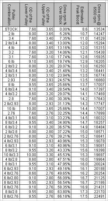

For you FRPP, 2nd Gen Lightning, '03-'04 Cobra and Saleen guys out there who might have been wondering, I found this chart over on another board and though it might be a good reference for you guys who were curious as to pulley swap combinations for your Eaton.
I'll post it over in the Power Adder section too, but since most of the Tech Questions are fielded over here, I thought this would be a good place to view it as well.
Mods may or may not want to make this a "sticky", but feel free.
