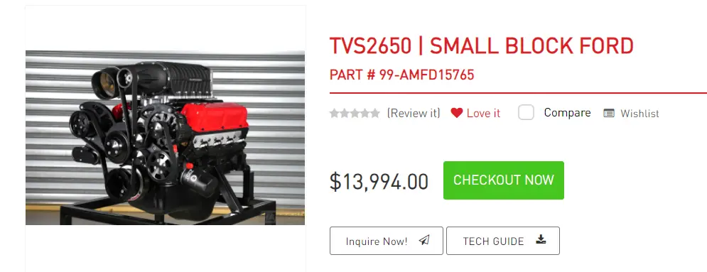

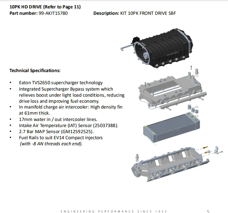

Huh, just stumbled across this. Looks interesting. A modern Eaton intercooled TVS style positive displacement supercharger kit for small block Ford. It's even 50 state legal.
After reading the tech download from their website, it's not the typical plug and play set up most of us think of when we hear "kit". Swapping to a coil on plug / crank trigger setup is needed, and accessory drive mods. So cost it's likely going to price most out. But I like it none the less!
I was reading the company bio. It looks like Harrop is an Australian company that provided Ford Australia and Loutus with custom manifolds to adapt superchargers for production vehicles. So I'm guessing they know what they're doing.
https://www.harrop-usa.com/tvs2650-small-block-ford/p160
Not included in that kit is the Engine Management system for the CNP, the cam sync, the Ignition system for CNP, the plumbing/tank/pump for the I/C and quite a few other misc items.
Figure $17-20K to pull it off.
Not counting labor, assuming you don't install yourself.
