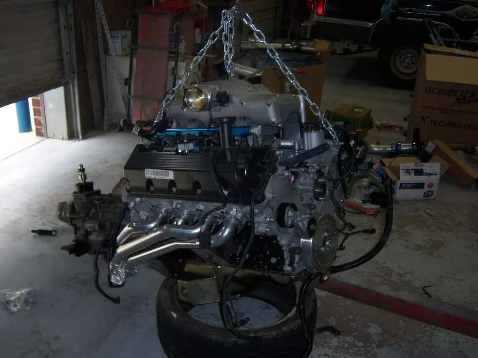

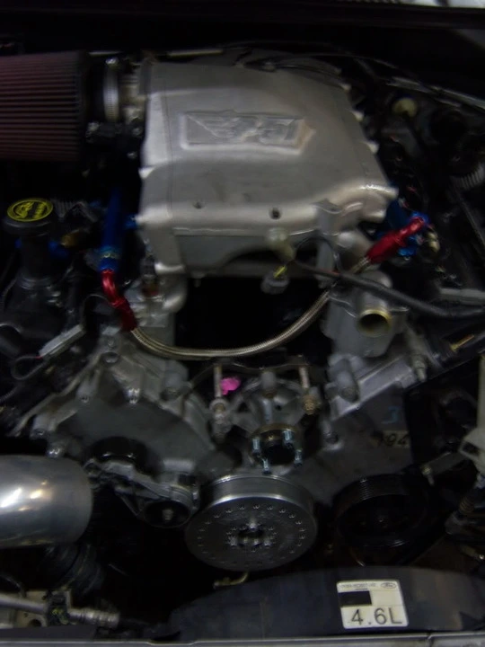

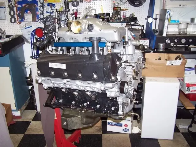

ok so i got the k member and the coil overs all done and most of the piping up to the turbo complete. The directions that came with the kit suck ive been winging it all of this way up untill this point where im supposed to drill the oil pan for the feed and return line to the turbo the kit came with no good pics of anything so i dont know where to drill the holes i called the company this morning and told them to email me pictures so i could get this done they said no problem but i still havent got any pics from them any body have any pictures for me i need help bad.

you just tap the pan for the return line. i tapped mine dead center under the crank pulley. i have the punch you need if you want to pay the shipping there and back i'll send it to you.
just drill a small pilot hole then use a hammer to tap the punch until the hole is the right size. then just use a tap (i have one of those you can use also) to thread the metal you pushed into the pan. i used some JBweld on the fitting once it was installed to keep it from leaking. (yes it will leak without sealing it up)
you use a port by the oil filter for the feed line. i dont remember the size fitting but you just take a plug out and install a flare fitting for the feed line.
if you need pics let me know and i can try to crawl under the car and take some

heres a few pics i found. you can see the oil drain fitting is the gold/brass colored piece under the crank pulley

I really appreciate the pics it helps me out alot
