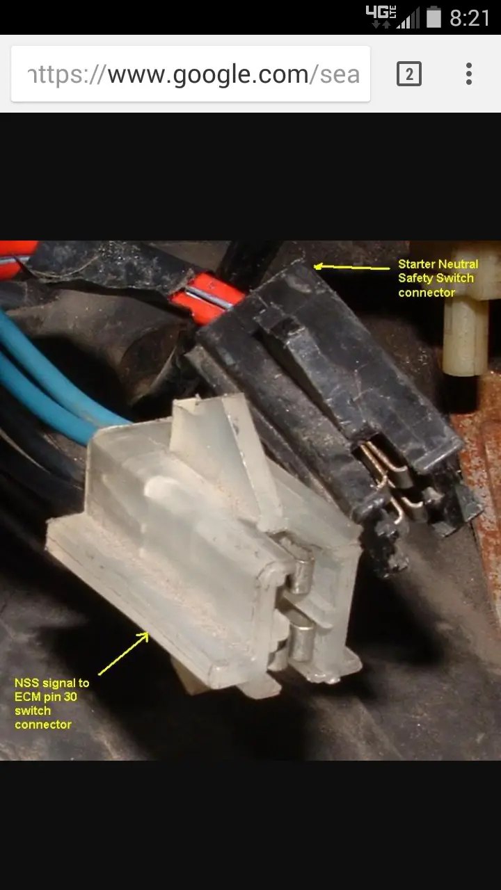

Remember to pull the jumper out of the clutch switch plug and plug it into the clutch switch. It helps the computer sense when the clutch is pressed for proper idle strategy and to hang rpms while changing gears. Also, it allows the car to start only when the clutch is pressed in. Here's a pic from Google. Both plugs need to be plugged in.
