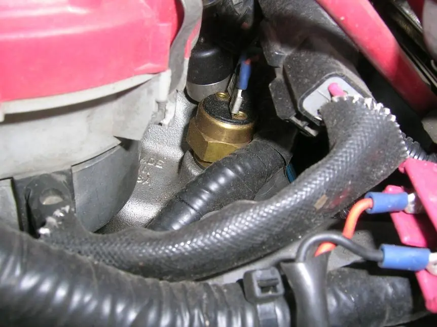

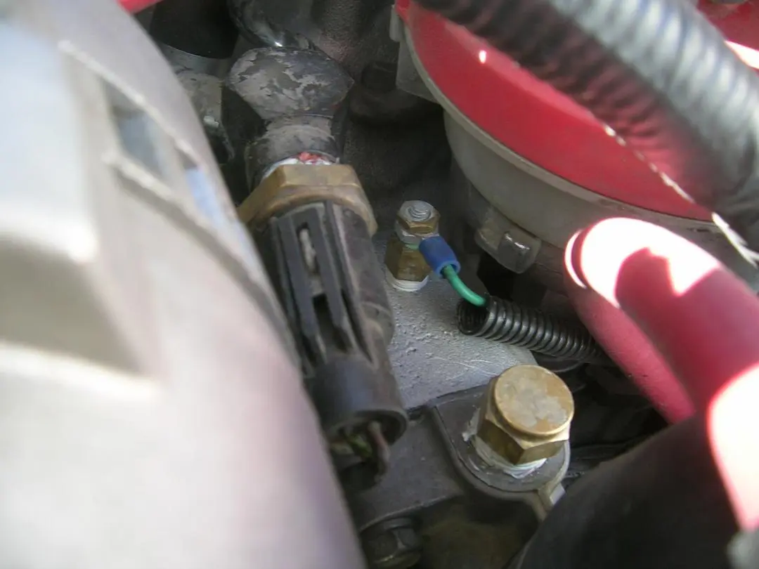

I installed my sensor for the fan to come on at 160 in the original hole that the ect was in. Then I drilled and tapped a hole just behind the thermastat housing for my after market temp gauge sensor. Here are some pics.
I have one question, I do not have the factory ect installed so my temp gauge in the car does not read. Does this affect the car in any way as the computer doesnt see a temp reading.

My fault on the ECT had a brain fart. The reason i tapped that hole was because I wanted both the temp sensor and the fan sensor to be behind the thermastat. Anyway sorry about the confusion.

You can see in yellow's second pic the ECT sensor is where it's supposed to be.
His second pic is NOT The ECT sensor...that is a Water Temp Sending unit.

The ect is in the second pic just left of my after market water temp sensor for my after market gauge. I did not realize there was two temp sensors sending info to two locations.

Why is your ect not located in the stock location.

LOL...my eyes focused RIGHT on the sending unit without even seeing that
The guy I bought the car from for the engine deleted the heater core and did not have the hard line hose to put it in. He had located it in a port on the back pass side. WHen dropped THAT engine into my car, I reinstalled the hard line hose but just plugged up the stock opening and left the ECT where it was. Right now as I type Im just waiting for a duct-cleaning Co. to finish in my house so I can go back out. I just put in new sensor in the stock location and I just need to move the wiring.
