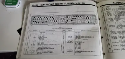

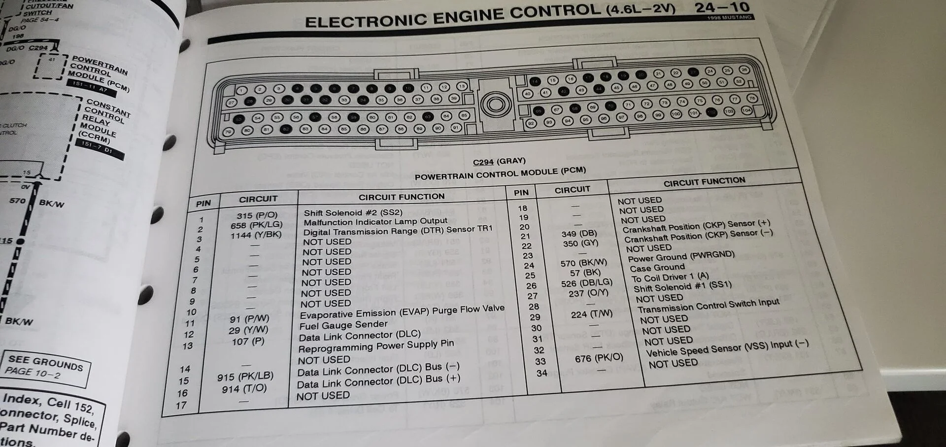

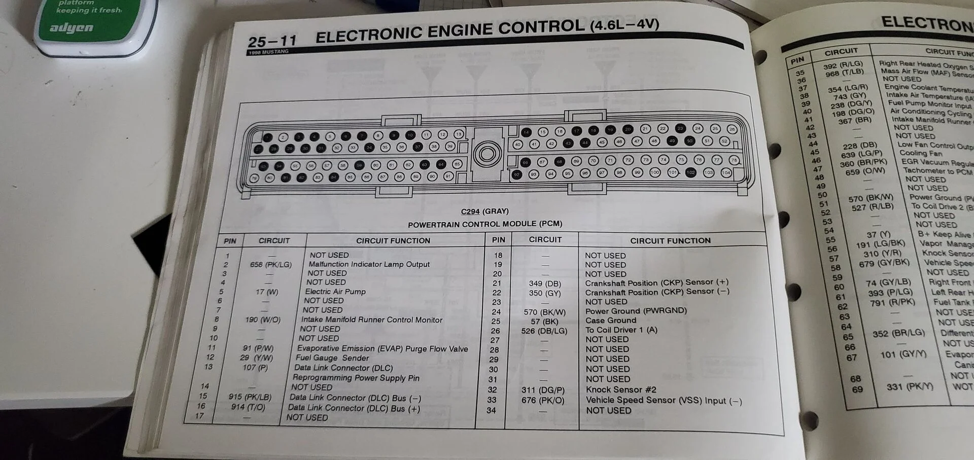

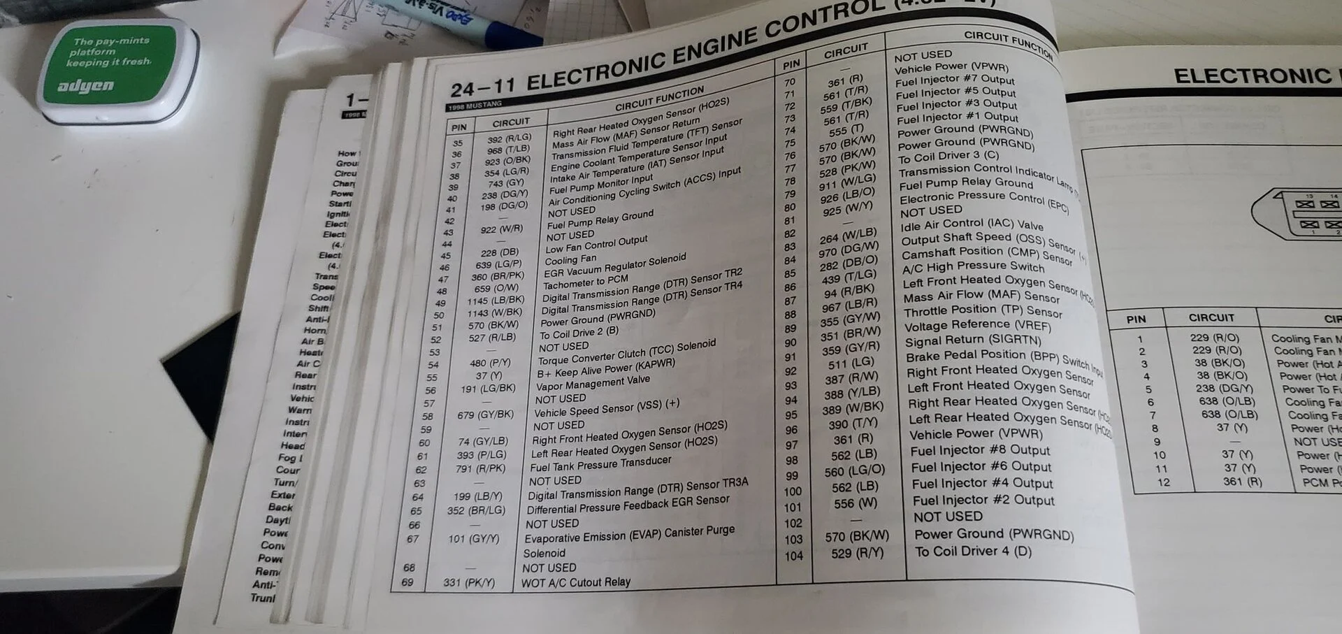

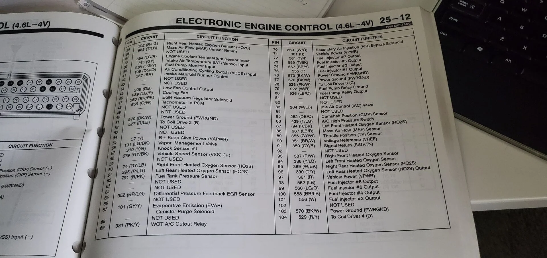

Well, a 2V ECU would work if you adapt the wiring to the engine. You would have to loose the knock sensors and IMRCs (or find another way to run them), as the 2V ECU doesn't have provisions for those, but people have definitely successfully swapped 4Vs in place of 2Vs. I'm looking at the pinouts for a 98 2V vs 4V and there isn't a ton of difference.
Sure. These are from the 98 EVTM. The top (that shows 2V or 4V) is cut off no one of them; it's the second page for 2V.
