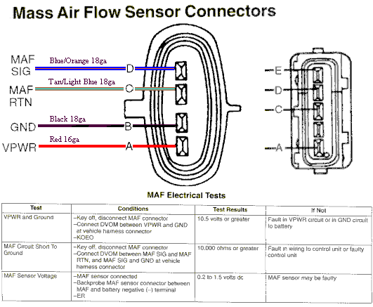

34 - egr not closed when its supposed to be...might want to take it off and clean it, carbon buildup will cause this. otherwise you may need a new egr sensor. could be causing some of your driveability quirks.
66 - MAF below test voltage...this is a real problem and will cause driveability problems. try these test:
67 - gear switch is probably faulty or wiring not hooked up. shouldn't cause much trouble though...possible idle issues though i've never had any (my switch is faulty)
96 - fuel pump secondary circuit failure...could simply be a faulty relay or open wiring going to the relay. you could check the wire going to pin 19 at the ECM with engine running for 12vdc...if present than it could actually be an ECM problem. my suggestion though, reset codes and see if this one comes back. i've gotten it from time to time and have had no problems because of it.
actually it would be a good idea to reset codes(by disconnecting the battery for 15 minutes) and see what codes return. also run the self-test and follow the KOER test with a quick tap of the throttle to initiate the cylinder balance test. this will tell you if you have a compression issue, bad spark, or a stuck fuel injector on one cylinder...and it'll tell you which cylinder. let us know
BTW, that yellow text was nearly impossible for me to read. probably have better luck getting responses with a different color. my2cents

Code 66 MAF below minimum test voltage.
Insufficient or no voltage from MAF. Dirty MAF element, bad MAF, bad MAF wiring, missing power to MAF. Check for missing +12 volts on this circuit. Check the two links for a wiring diagram to help you find the red wire for computer power relay switched +12 volts. Check for 12 volts between the red and black wires on the MAF heater (usually pins A & B). while the connector is plugged into the MAF. This may require the use of a couple of safety pins to probe the MAF connector from the back side of it.
There are three parts in a MAF: the heater, the sensor element and the amplifier. The heater heats the MAF sensor element causing the resistance to increase. The amplifier buffers the MAF output signal and has a resistor that is laser trimmed to provide an output range compatible with the computer's load tables.
The MAF element is secured by 2 screws & has 1 wiring connector. To clean the element, remove it from the MAF housing and spray it down with electronic parts cleaner or non-inflammable brake parts cleaner (same stuff in a bigger can and cheaper too).
The MAF output varies with RPM which causes the airflow to increase or decease. The increase of air across the MAF sensor element causes it to cool, allowing more voltage to pass and telling the computer to increase the fuel flow. A decrease in airflow causes the MAF sensor element to get warmer, decreasing the voltage and reducing the fuel flow. Measure the MAF output at pins C & D on the MAF connector (dark blue/orange and tan/light blue) or at pins 50 & 9 on the computer.
At idle = approximately .6 volt
20 MPH = approximately 1.10 volt
40 MPH = approximately 1.70 volt
60 MPH = approximately 2.10 volt
Check the resistance of the MAF signal wiring. Pin D on the MAF and pin 50 on the computer (dark blue/orange wire) should be less than 2 ohms. Pin C on the MAF and pin 9 on the computer (tan/light blue wire) should be less than 2 ohms.
There should be a minimum of 10K ohms between either pin C or D on the MAF and ground.
See the following website for some help from Tmoss (diagram designer) & Stang&2Birds (website host)
http://www.veryuseful.com/mustang/tech/engine/images/88-91eecPinout.gif
Try cocking the MAF (rotating the MAF housing) if everything checks out good. Some CAI kits cause turbulence in the airflow that upsets the MAF sensor readings.
