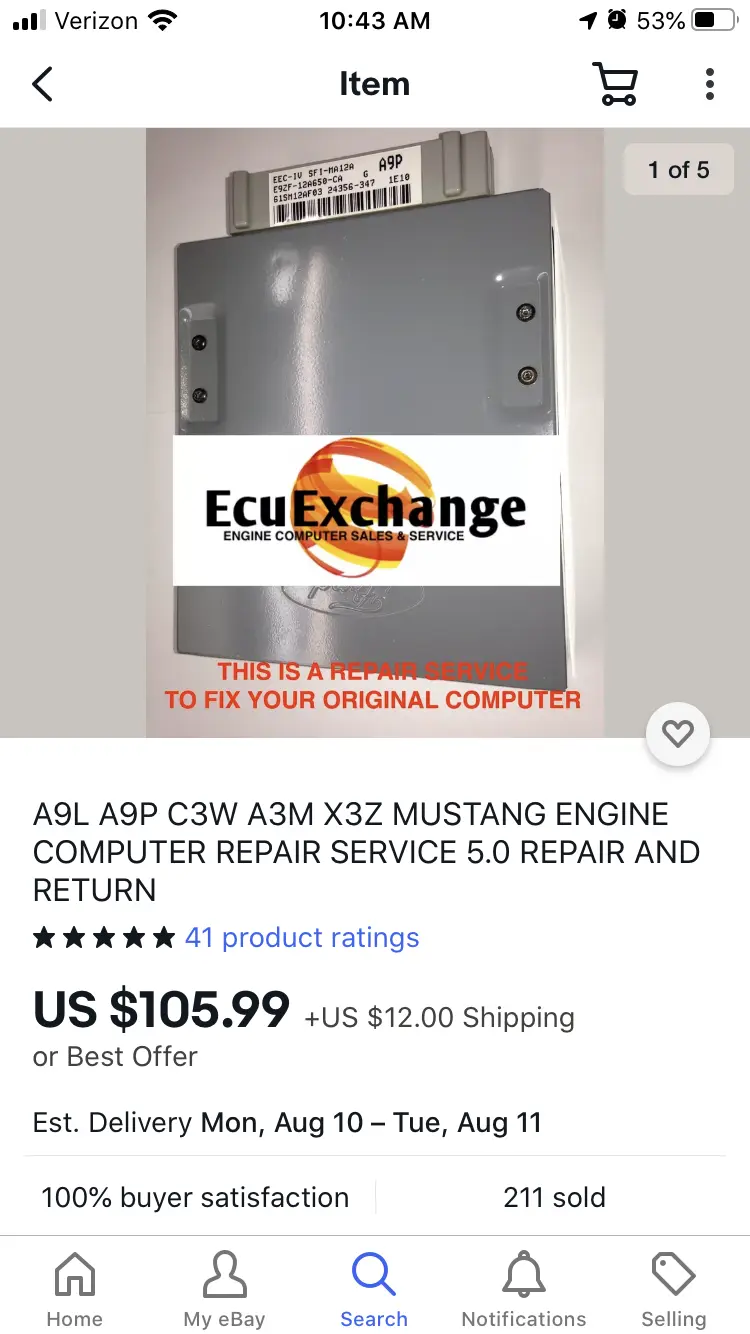

If in doubt about the capacitors or used computer, the turn around time for ECU Exchange is short, and the service was great. It was also cheaper than a remanufactured one from a chain parts store last time I looked. The pic is a screen shot of them on eBay.
Yeah I found it on eBay. It’s not aftermarket it was pulled from an 87 5.0
