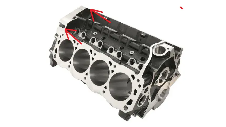

When you install aftermarket aluminum heads on a 302, there is a small gap between the deck surface and the head surface in the center/rear, just outboard of where the cork gaskets would sit.
You can actually slide a credit card through that slot with the heads installed.
So, remove the intake (upper and lower), remove the cork gasket(s) if used, apply new sealant, and ensure you spread that sealant in that gap from the [inside]. Again, those gaps are [just] outboard of where the cork goes (whether you use the cork gaskets or not).
