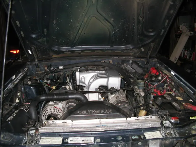

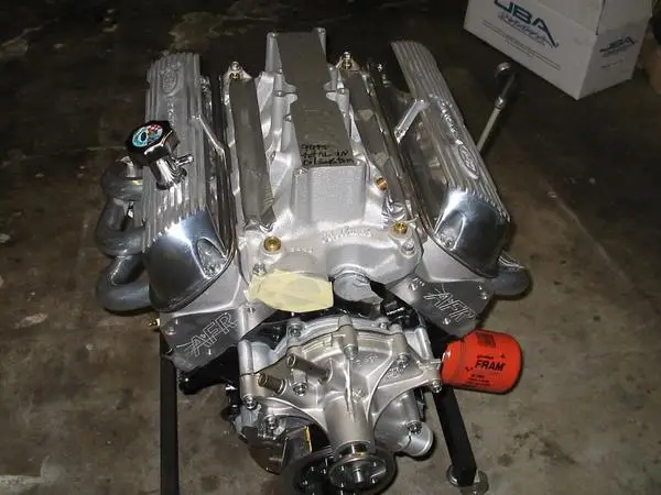

Here are mine. I have an old style Performer RPM intake on it. No intake spacer, but I don't know how much taller the RPM is vs stock intake
