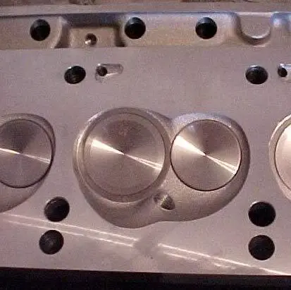

I called edelbrock and discussed it with them. The first thing the guy said was did you drill the steam vent holes. I checked with the mechanic and he did not drill the holes. Edelbrock says it should not be running any hotter than before the new heads if installed correctly and that the steam vent holes not being drilled will definitely cause overheating.

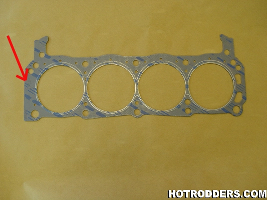

I would not drill the "steam holes". The coolant should enter the cylinder block, travel all the way to the rear of the engine, then up through the large coolant holes at the rear of the head, forward to the front of the head, and into the intake manifold. Drilling the holes allows coolant to bypass the rear of the engine, which keeps the front nice and cool but allows the rear half of the engine to permanently overheat.
You should also be using a genuine Ford 190° thermostat, which is what the engine was designed for. Use the Ford, I have seen too many aftermarket units run erratically.
The arrow points to the front, which has no coolant passages, the large holes at the rear are for that.

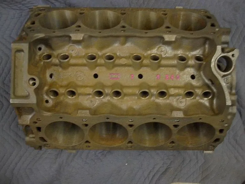

2+2 is not correct. You MUST drill the steam holes. I had the same issue. Asked my buddy that works for Edelbrock and he gets a lot of calls from people what know more and will not drill them and chase the overheating every which way.The heads are made for newer blocks and by drilling, they can be used on older blocks

The "steam holes" are misnamed; all they do is allow trapped air to be purged from the uppermost portion of the block's cooling jacket. They are not large enough to disrupt the primary flow of coolant.

As for Edelbrocks' instructions, I fail to see how drilling a 1/8" hole, lower down than the 1/4" factory hole will accomplish anything at all.

Yeah, it's really been a problem since Ford completely omitted that 12:00 coolant hole in the early '80s.
Oh, wait...
Hmmm… That would mean about a spazillion SB Ford engines don't have these holes, such as my '97 5.0, which is in a truck, and and never overheats (or even goes above normal) even in heavy traffic, on 98° days, with the AC pumping out ice cold air… I see your point.
Per Edelbrock the steam hole is...
To prevent a hotspot from forming in that part of the head, being as aluminum shrinks and contracts at a different rate than iron, it only becomes a problem when your using aluminum heads on the iron block. I went thru the same thing about 4 years ago.
So, is there any way to tell whether you have a "new" or "old" block that requires drilling? My'68 is running hot and I can't remember whether I checked or not before installing the heads. I'd hate to have to tear down the engine to find out if this is my problem.....
