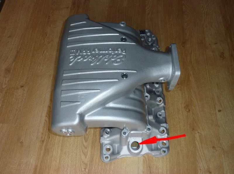

Please can someone explain what the hole arrowed in the pic below is for on the back of my new intake ?

That is where the PCV valve goes.
You are missing the screen, grommet and actual PVC valve and related vac lines.
You can either take them from your stock intake...or buy the parts (screen, grommet and valve) from a motorcraft distributor
I'm pretty sure you can even buy non-Motorcraft replacements at pretty much any auto parts store. It's a standard part(s), more or less.
It's likely that if the thread starter didn't know what it was, that the originals on his car have not been changed in a while and should probably not be reused.

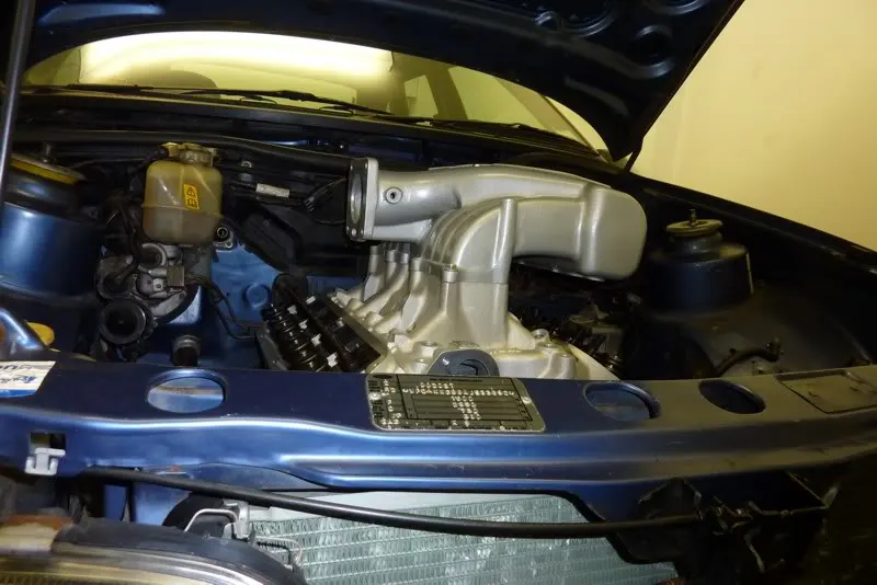

Engine is in a European Ford Sierra 5 door, I think you call them Merkurs in the US ?
New intake just clears the hood.
