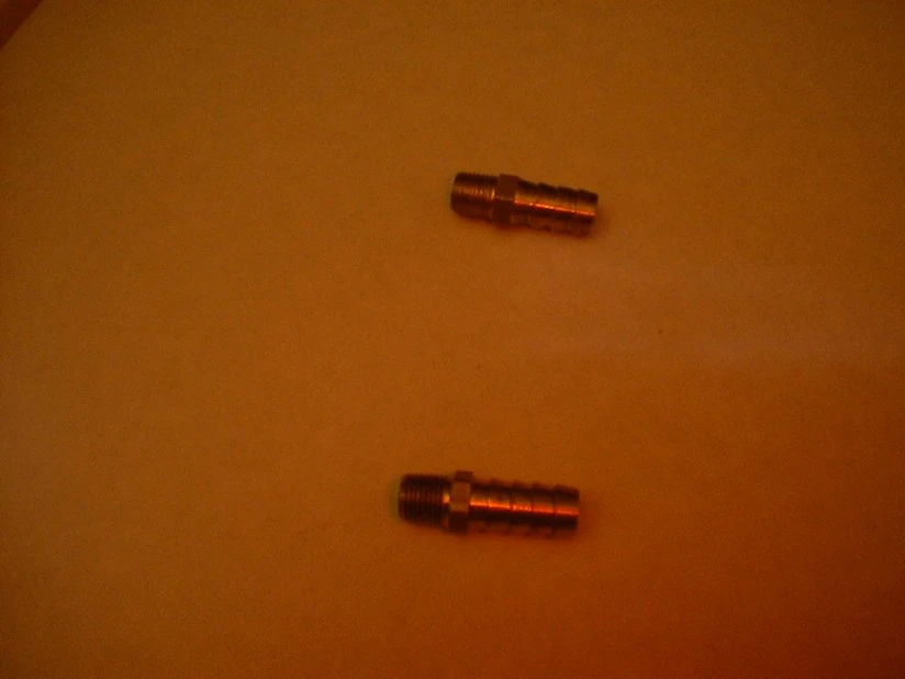

here is a pic of my vacuum fittings that came with the intake. i dont think these are the right ones. i have the plugs in the intake that faces the front of the car and on the back there are three holes 2 big ones and a small one. now one of those holes gets a piece from the stock intake while the other two get new stuff. both fittings fit the small hole, and the large vacuum hose. do i need to call edelbrock and get the right stuff or is there a trick here.

I'm using 2 fittings off of my stock intake. The "L" shapped one, and theres one with 3 fittings on it (1 big, 2 small) and One of thoes from the kit. I have my brake booster running to the "L" shapped one, PCV going to the other big one, fuel pressure reg and red vac line going to the other 2 small ones (same piece), and the 5th vaccume line is coming from the passenger side running along the firewall almost, and that one went to one of the fittings Eddy. supplied.
If you can get a picture of the under side of the upper intake, I'll show you how I have mine setup
Well, I'll tell you what I did -- I used a small cone fitting that came with the edelbrock for the vacuum line (only one which hooks directly into the intake itself, the big vacuum line hooks into the elbow), and I used a larger cone fitting that also came with the edelbrock to hook one of the PCV hoses to. I couldn't get the other PCV fitting from the stock intake to fit without banging into my valve covers (Fox covers, might be taller than stock 94/95 covers), so I just plugged that hole with a pipe plug and capped that section of the PCV off. Why the PCV has two connections to the intake, I do not know, but mine seems to work fine with just one. The extra plugs I needed I got at Home Depot, there were not enough of them with the intake as shipped from edelbrock.
