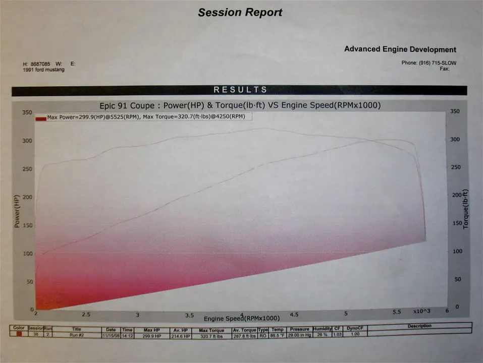

I have almost the exact same combo. My car has eddy 2.02 heads, e cam, & an RPMII. Granted its not the best combo, & a regular RPM would make more low end, but I bought the motor that way & I plan on building a 347 soon, so no point on downgrading to a smaller manifold...
BTW, my car made 299.9 rwhp & 320 rwtq & this was with a totally stock fuel system... With a better cam, the power curve would be better, but can't do much with stock pistons & 2.02 valves...
