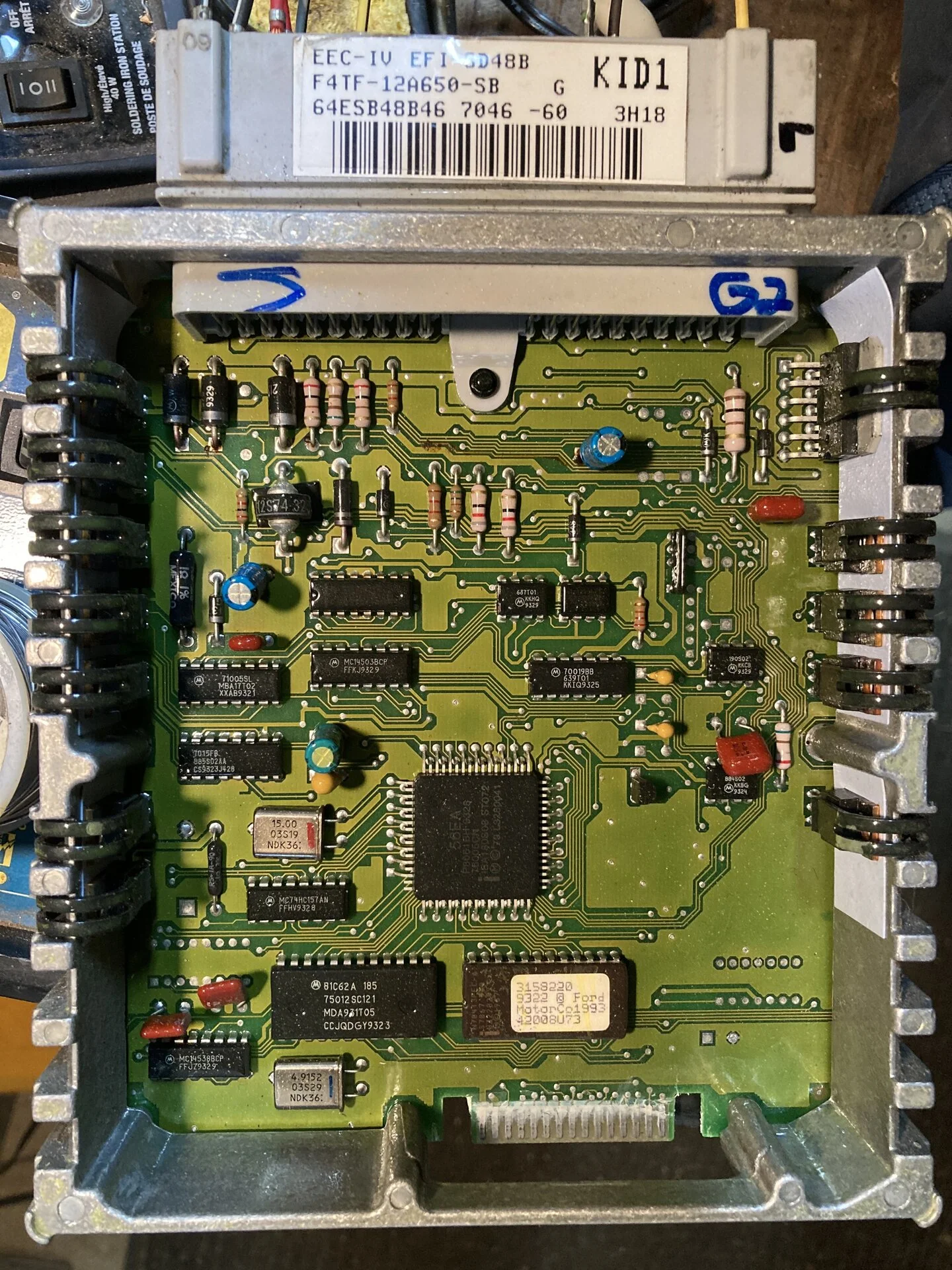

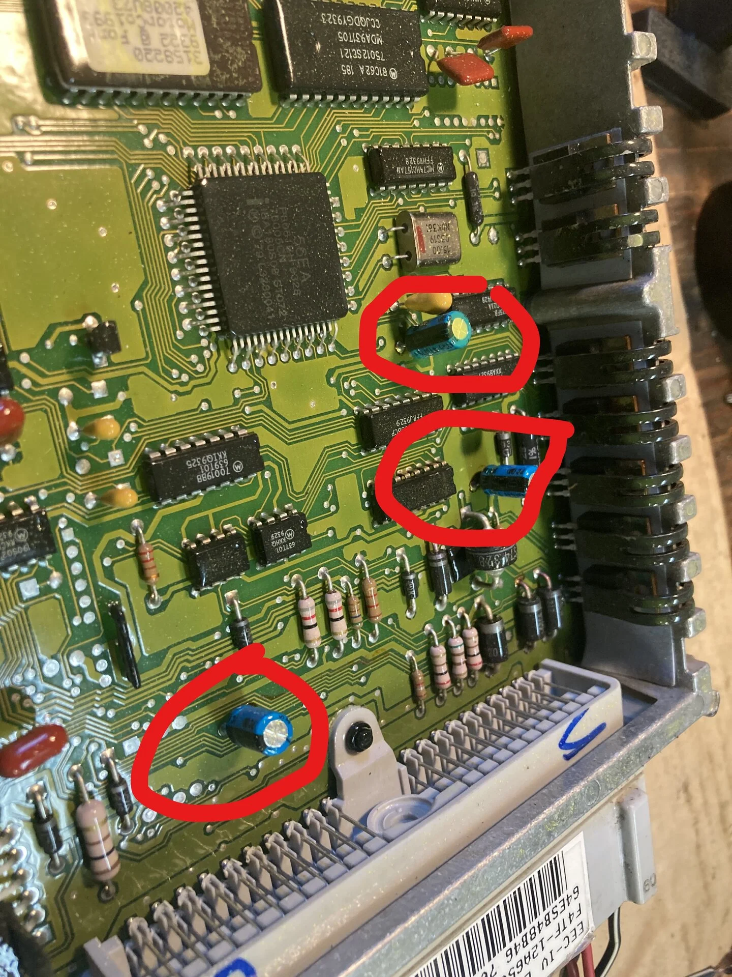

Since this thread is about capacitor replacement, Who Wants Photos?
Here is the board, sitting since September 2021 on the shelf, worked perfectly in vehicle.

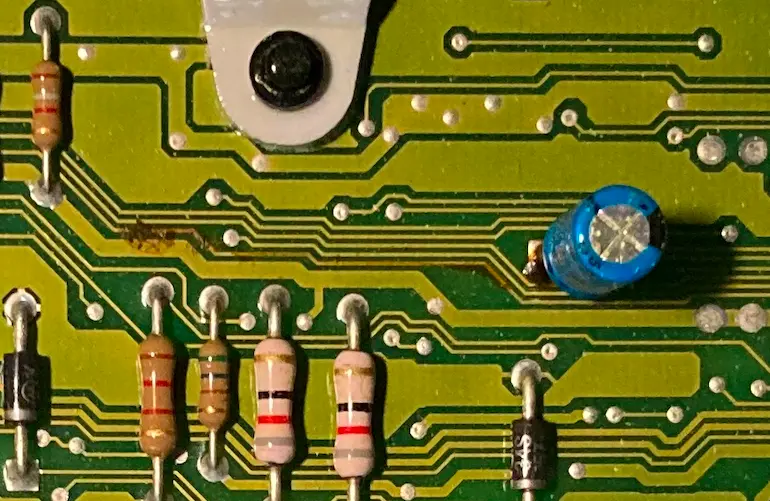

Looking at the picture, from top to bottom, I'll refer to the capacitors as #1, #2, and #3.
Cap #1, shows signs of leakage, hard to see just looking, but under the magnifying glass, it's bad.

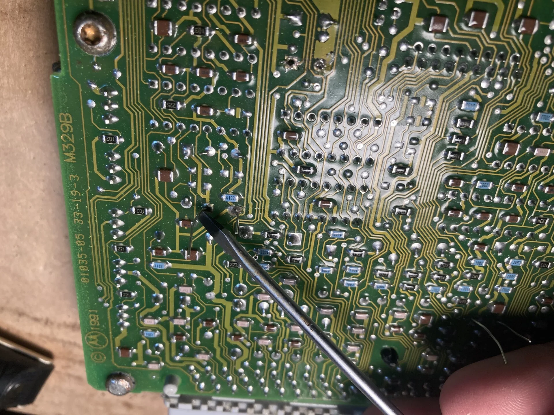

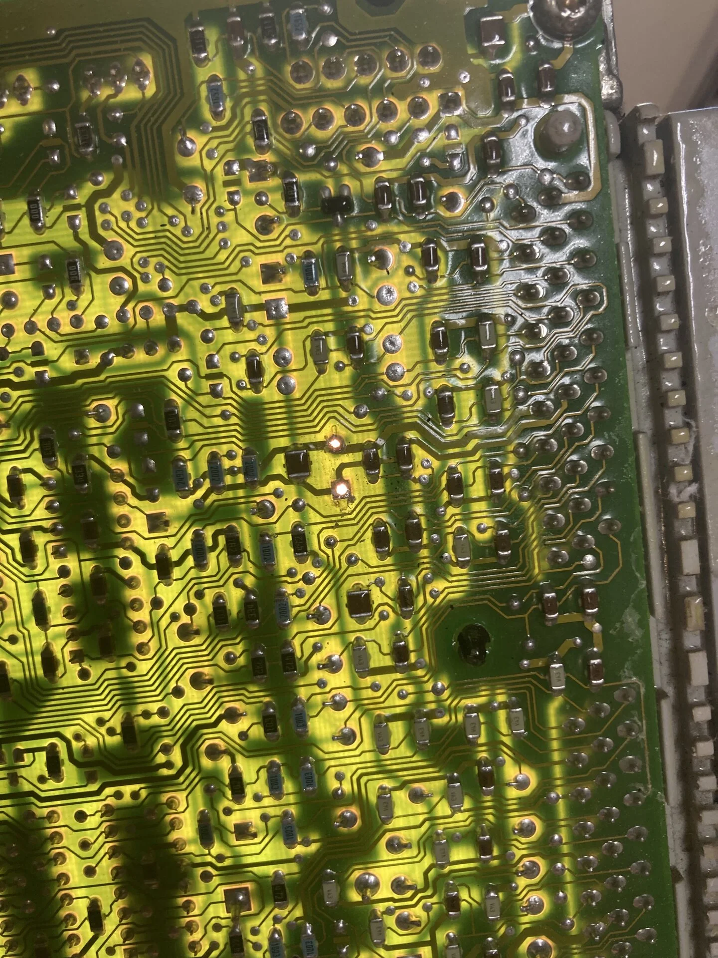

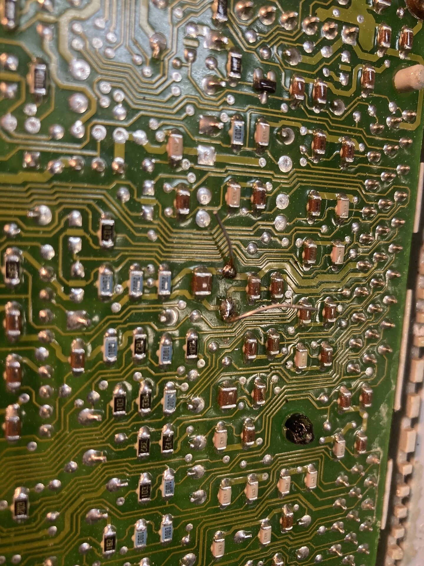

Next up, identify the capacitors pins, identify capacitors orientation, flip board and desolder/unsolder remove the capacitors.
When removing the capacitors, there are basically three(3) ways:
1- clip cap off one side, then fight with the little wires and solder to get it clean
2- pull slight pressure out on cap, while heating solder side to melt solder, unit will pull out easily
3- heating solder side, use solder sucker to remove
Problem with #2, you can pull a trace off the board if the temperature is not correct.
