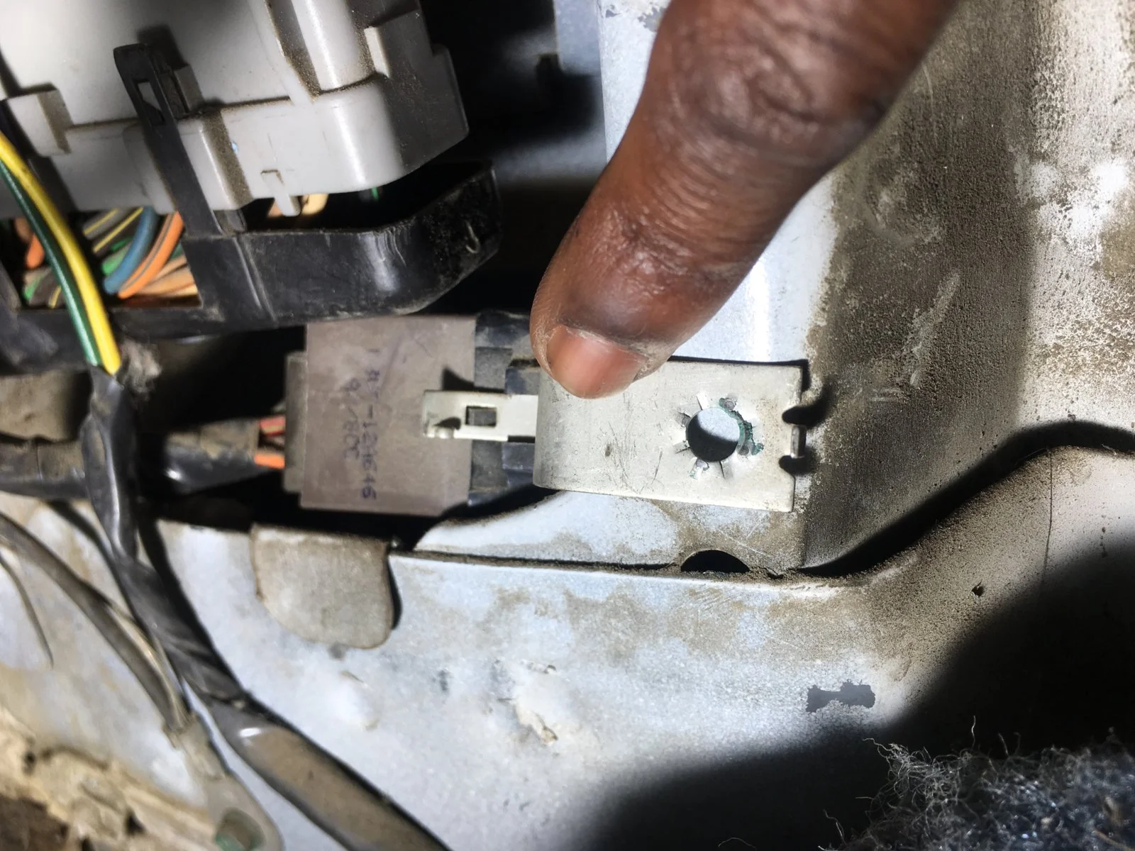

Is this the eec relay?

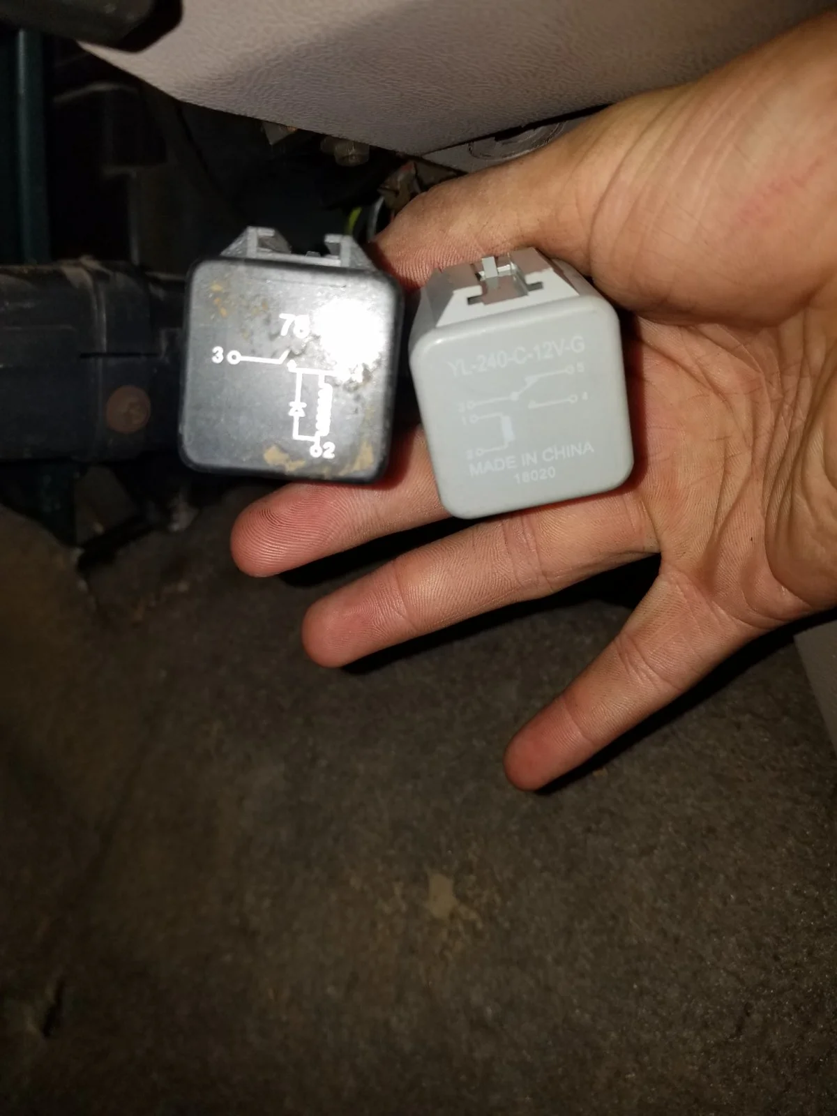

Is there usually two relays behind the radio?
Did you remove the passenger side dash speaker to look for the relay?
Yes I did. If the eec relay is the only relay that has a brown connector then I'm guessing it's one of the relays behind my radio.

I know this is a year old, but mine is located on the top of the EEC bracket. Haven't found a way to change it because I cannot get the bracket off the wall. I will try to post a pic later.
