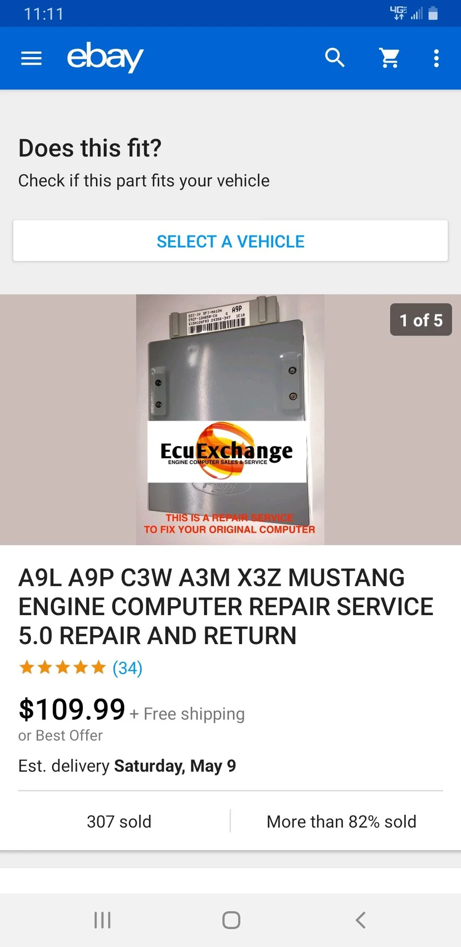

That's what I needed to know, I'll stick with the stock ECU. Do you have a website or phone number for Ecu Exchange? This one came from a wreck that was hit hard. It doesn't look damaged, but I would like to make sure.
Their service is found on ebay. If you Google ECU exchange you'll see it. Here's a screen shot I took.
I think I used them to repair a hypochondriac, psychotic A9l that was spitting out different codes each time it was scanned. The problem was a couple of old capacitors. They replaced them all and did something else like upgrade the ground trace and it was quick.
