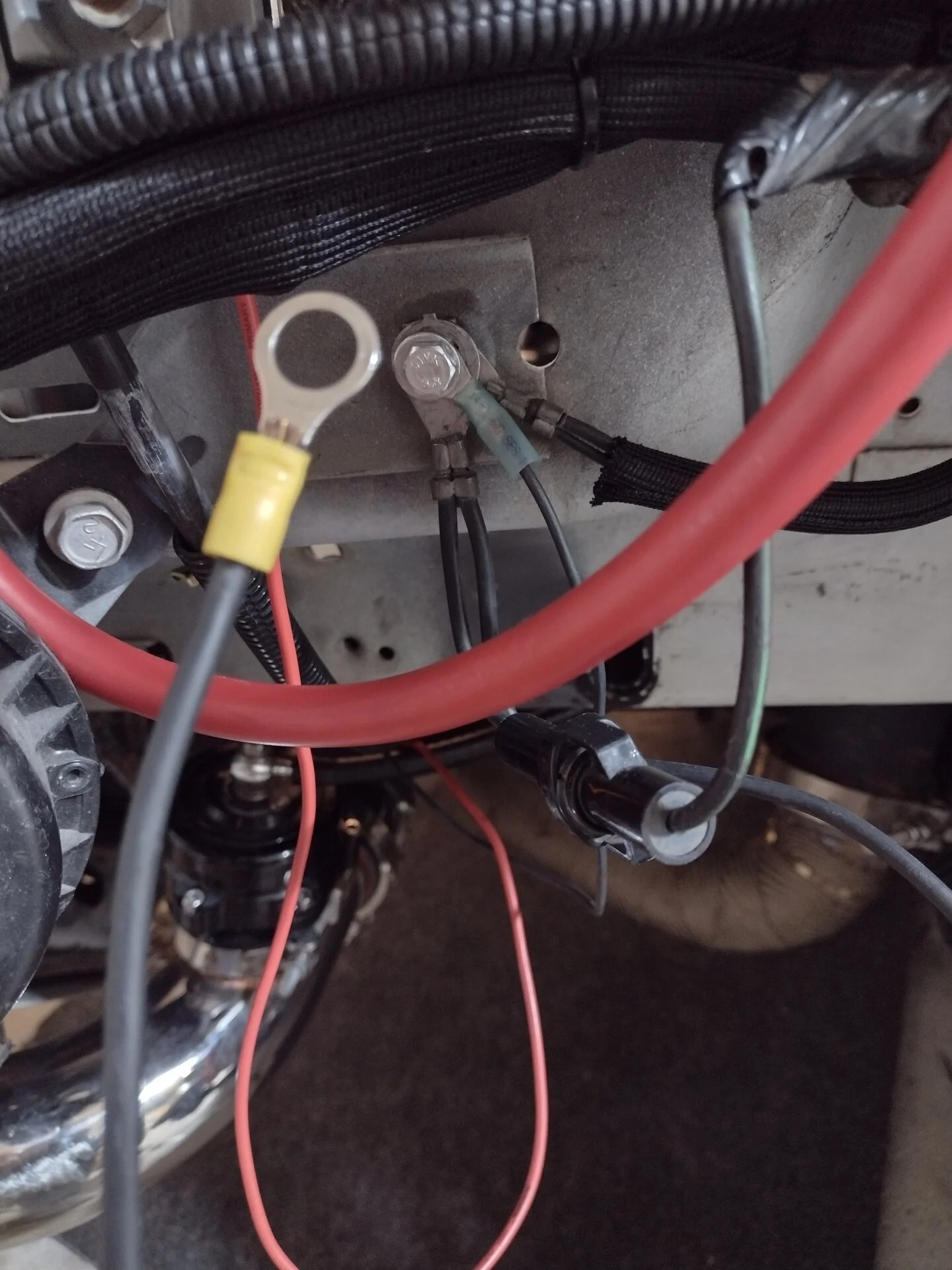

Relocated battery to trunk. I have the efi connector grounded to the location shown in the pic. Where does the other end go? I swore it was connected to the ground cable of the battery. The eyelet shown is the end with no home.

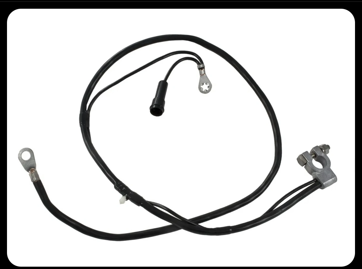

one end connects to the Neg terminal of the battery. One eyelet near the circular connector grounds and the other end goes into the harness. Where escapes me at the moment I need to look at my car
So,do I need to extend that wire all the way to the battery?

Runs like this

That appears to be a yes then. Funny,all the battery relocation stuff I've read/watched, this is never mentioned.
I would, but then I wouldn't stack all them grounds at the same place, but I'm kinda weird.

That eyelet goes on the radiator support on most Fords
The round one is the processor ground, which if disconnected, the car will not start
You can put as many grounds in one place as you want?

And here's where a writeup needs to be done. Like I said earlier,there's several different ways to do it. Apparently people have success with it their way. The grounds in one place does not concern me,why would it? I do work for an Asian car manufacturer I'll up date my "build" thread when the new starter shows up.
