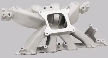

What's the difference between this intake and Edelbrock's Torker II?
http://store.summitracing.com/partdetail.asp?part=EDL-2760&autoview=sku
(in case the link doesn't work, it's the EDL-2760. $236 through Summit)
Torker uses smaller than stock ports to increase velocity.
Torker also uses engine heat from lifter valley and exhaust crossover.
The 300-13 Holley is totally seperate from heat and uses larger ports and plenum.
It is long considered the best street/strip intake for the 351c.
I don't know how it stacks up against all the new Aussie intakes though.
The 300-13 has what you would consider a legendary or cult status in the Cleveland world.
It's hard to tell from the pics, but if you look hard, you can see how all the plenum and runners are completely detached from the lifter valley.
You can put your hand under the intake, and over the valley cover.
Similar to the Air Gap intakes.
Edit: I have seen folks cut the webbing out of the Torker and block the heat risers. Forgive the crude rendition, but this is what I have seen, then they use the pan type gasket to seal the lifter valley.
