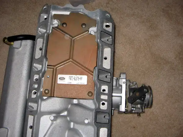

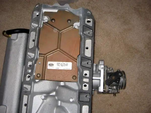

I have read about this before. I want to say there is supposed to be a baffle under the PCV valve on those cobra intakes. Did you install it? The chinese versions seem to be worse. Also, you can call FRPP tech line if you don't have the baffle and need it. 1 800 367 3788
Yea, it is the chinese version and I did install a new baffle. This problem started before the rebuild and I lazely assumed it was bad valve seals, blow by, etc. But that is not the case now. I bet if I re-installed the OEM HO intake the problem would stop.
Do you have the larger baffle?
http://forums.stangnet.com/671309-fords-fix-frp-cobra-intake.html
Maybe you have the baffle installed upside-down? I know some of the baffles are angled on the leading end, the angle should face the manifold, not the lifter valley. As you accelerate, the oil will go to the back of the valley, and if that baffle has the angled part facing forward and down, it will scoop oil up. You could also have a bad pcv valve?

strtrcr50: I took a lot of pics of my rebuild when I was doing it so I will try and dig up a pic of the lower but I am pretty damn sure that the baffle that mine came with is WAY smaller than that one in the pic you provided. When did FR make this change? I was thinking about ditching the cobra and going with an Ede RPMII.
I don't know. I just know I was reading about it. I think that baffle might be the same as is installed on the newer explorer. You can see the part number if you want to give it a try. The guy I linked to got his 11/06
