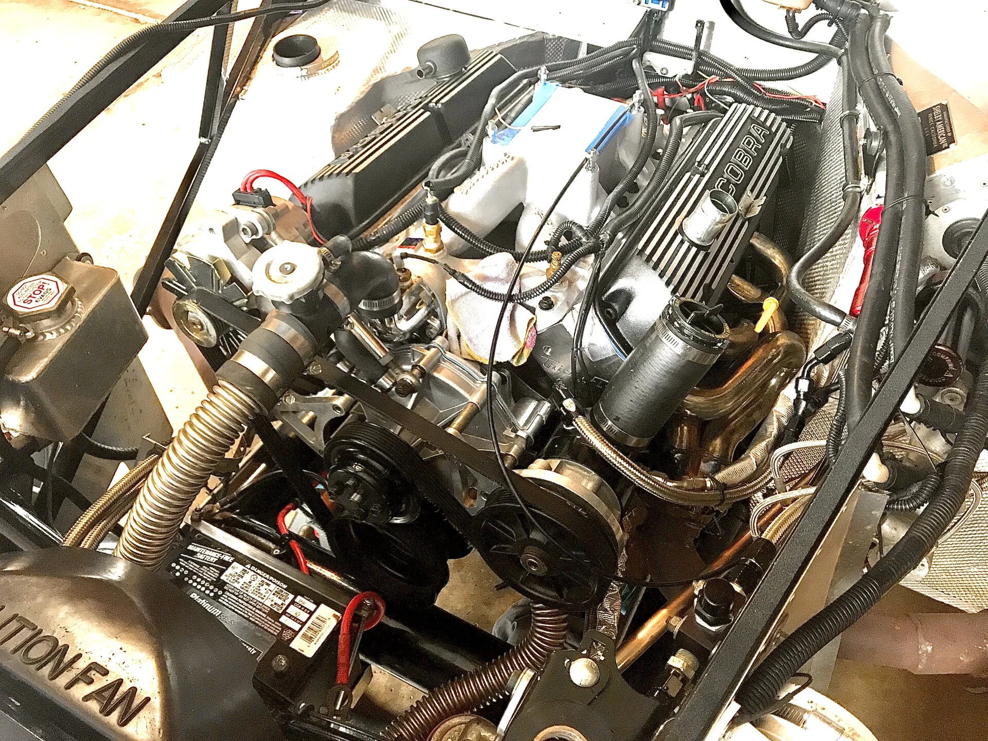

Hello, I am building a Factory 5 Cobra with an 89 GT mustang engine. To make it more period correct, I am going to a carb set up. I have it almost finished and just bought a Distributor for a 85 Mustang GT 5 speed. The old TFI dizzy was longer and this one is shorter. I checked with a gauge and it appears as though with the 85 distributor, I will only make about .170 of shaft contact. Should I get a longer oil shaft and if so, please tell me the part #! I cannot find anything on the subject. Thanks!

the difference is.500 in length. I did not know they are not the same diameter
I think I biffed! I tried to prime the engine by cranking it over. i assumed the shaft was short and its not. I changed out the oil filter and oil beforehand, and used assembly oil on the lifters and rockers. I am thinking I had an air bubble while cranking. i used a drill to prime and instant oil pressure!
