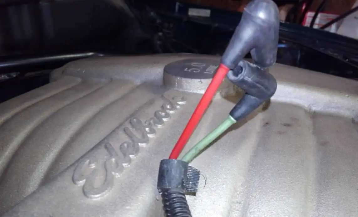

They still had the stock airbox in it. So I installed a BBK CAI. When I removed the stock setup i discovered there was a vacuum harness from the fenderwell, disconnected. Had Red/Green/Tan and White. I found that the Tan and White go to the air bypass solenoids coming off the smog pump. Well I deleted the smog pump and just plugged those lines. Just leaving the red and green lines. Here is the current setup

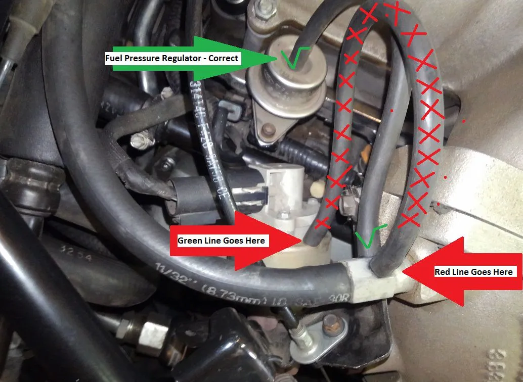

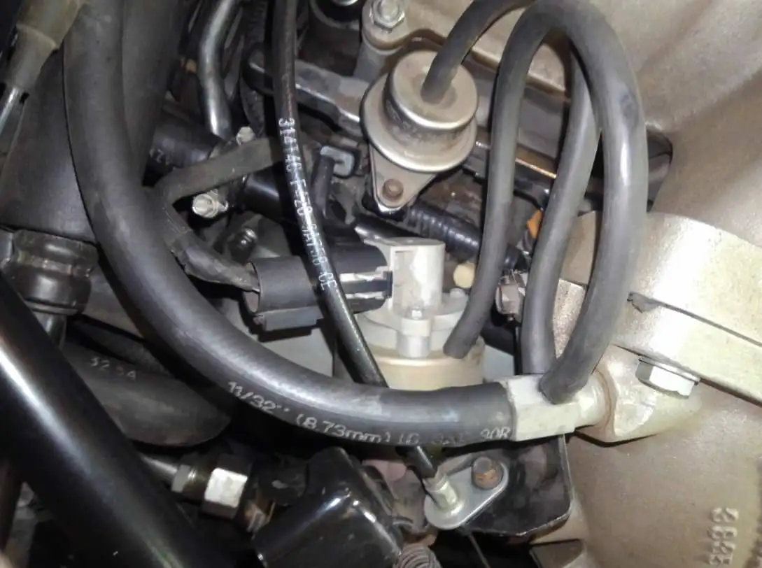

Now the car runs fairly ok, but I do notice the idling wonders a little bit, but most of all, just seems to run rich, even for a cammed car. I have the stock fuel system with 19lb injectors, and the car is tuned. After some checklist reading today, I realized the Red needs to go to the intake and the green needs to go to the EGR

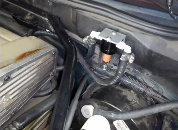

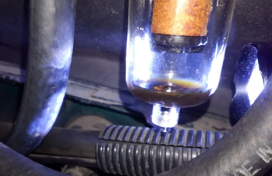

But with its current configuration, with the EGR hooked directly to the intake, will that cause it to be Wide Open all the time? Can that cause any rich conditions or poor mileage? I've read a few suggestions here that it could cause a lean condition too. One additional thing I noticed. I installed a new PCV valve, (had a spare in box but I think original was fine) and also a Steeda oil catch can I had in a parts box. Its my first catch can, but was a little concerned I caught this much in my first 20miles. Is this normal? Or indicator the car is running too rich? Or maybe something else?
You are correct, hooking the EGR directly to the intake will cause it to be open all the time. It's only supposed to be open at part throttle. The red hose feeds vacuum to the emission solenoids in the passenger fenderwell. The computer then decides when to put vacuum to the green hose, which opens the EGR valve.
Are you looking to restore the emissions equipment? It's possible that the red & green hoses (which are plastic and get brittle over time) are cracked and need to be replaced. Some folks simply unplug the EGR and disable it in their tune.

I decided to hook up the red/green lines where they should go. Here are the things I noticed in order
  1. Car startups with with HIGH rpm, near 2000 and then slowly falls down to about 1100-1200
  2. Driveability is greatly improved. Doesn't take much to get the car going. But that high rpm is annoying
  3. Decided to disconnect those lines, and cap off the solenoid on the EGR and the port on the intake
  4. RPM drops down to 1000rpm upon restart, driveability is a little rougher, eventually in 5mi the CEL came on, so I shut it off, reconnected the red/green lines, restart, CEL is gone
  5. Drive it for about 15mi and notice two things
A. Coming to a stop, the RPMS have a tendency to surge from the 1100-1200 and shoot up to 1600 and back down a few times.​
B. When at a full stop, and quirks settle down, idling at 1100-1200 if I just feather the gas, it drops down to 1000 and has a little trouble recovering​
So at this point, I'm clueless what to do. I can leave it at is, aside from the surging idle the car drives great. Or I can disconnect the lines, car returns to normal'ish, and the CEL comes on. Or put it back to the way it was and have the EGR open all the time, rpms stay at 1000, no surges, drivability decreases a touch 'feels like a cammed car'.
I'm going to continue through the checklist still. I checked my TPS earlier, parked with the ignition on, but not running I was only getting .02v to the tps. But I haven't checked it while running.
SOLVED - Turns out the Red goes to the EGR Solenoid, not the Green. I basically hooked these up in reverse, and now the car runs perfect. No more surging idle, no more CEL, no more rough take offs in 1st. I can actually see the EGR working now when under throttle. The way I had it hooked up before wasn't moving at all.
