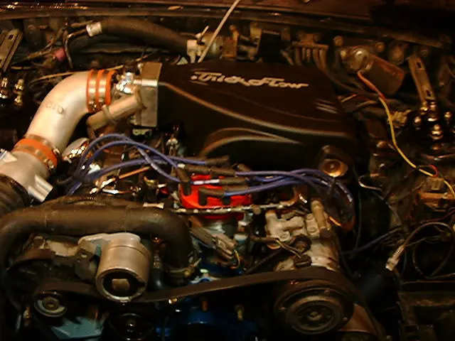

i deleted mine on my 306, no pinging or cruising detonation, and it idles just fine, the reason i didn't put it on is because i got my TB without a spacer so i didn't want to spend the extra $50 just to get a damn spacer so i deleted it. excuse the dirty engine bay (it has since been cleaned :nice: )

also i should have cleared up that i am getting the function in the computer turned off for the EGR system, i ditched everything and it really cleans up the engine bay without a million vacume lines everywhere. i am still running with no EGR and i would like to see how much it really improves gas milage cause i can't see it making a whole lot of difference.. maybe like 1/2 mile to the gallon more

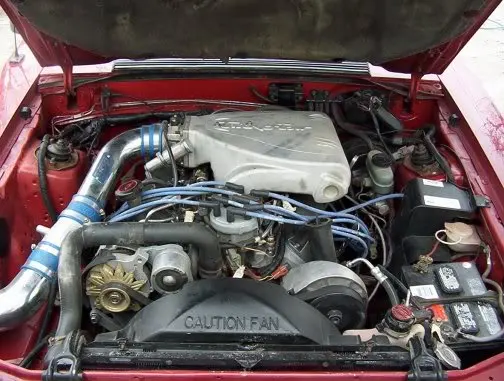

That is precisely how I adjusted mine - mine's all custom made with mandrel bent insulated 3.5" and 3.0" exhaust ells -- had to keep shortening the end of the ell that connects to the throttle body until the system cleared the strut tower.

I had mine shut off with my custom SCT tune/chip
