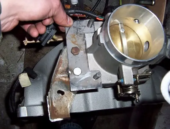

on my fox i deleted the EGR so i had to modify the bracket to fit, its kind of the same idea and may give you a starting point, i just raised it up a bit, as well i had to rig up a plate to attach it cause of no EGR spacer, i did tack weld it so it wouldn't move, but it is bolted on not held together with welds
heres a pic
imagine the pen is the throttle cable
EDIT i jsut noticed your car is AUTO, you may have to modify it different

i ended up notching the bracket for the tubes and welded it up to reinforce it a bit. i also spaced it out a bit with two washers where it mounts.
it looks alot cleaner and smaller now with out that stupid EGR spacer.
