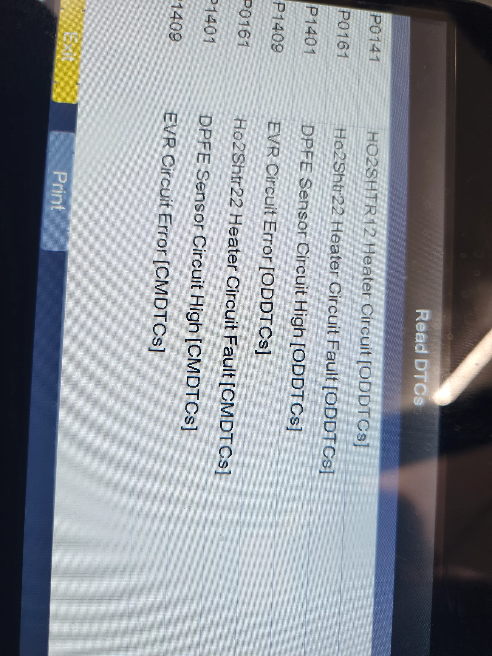

This is a picture after 17276397866741789938842448537892.webp test drive

I don't even have the rear o2 sensors in. And yes you are correct evap solenoid is gone. I was running without the front o2 sensors for a minute then this happened. I put them in thinking it was lean. But no luck
Another thought:
Do you know what codes you had (if any) prior to the incident?
I have to wonder why the codes for the EGR and EVAP are not suppressed with/by the SCT tuner.
