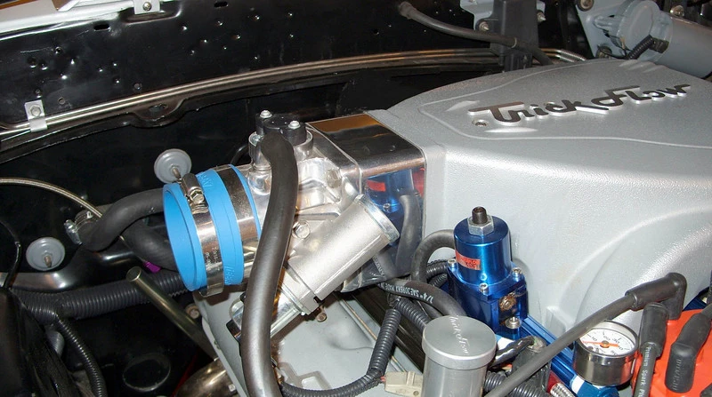

Deleting the EGR is common when removing all the smog crap (pump, check valves & hoses, solenoids, vacuum lines, pipe in back of the heads, etc.) Deleting the small water lines is just to clean up the engine bay and remove the chance of a water leak if the TB gasket ever fails. Some say the water supply to the spacer is to help cool it down in the summer and some say it's to keep the TB from icing up in the winter... I think it's for both. But I don't have them hooked up in my car because it's never driven in the winter and the cooling effect can't be too great because the temp of the coolant is about 190*.
And here is a good close up pic like I promised.

what did he/you do for the bracket for the tb cable that is mounted on the egr block? is there a piece there for a tap or bolt to go through?

nevermind, i just scrolled back up and looked at the other pic. is that threaded or for a bolt???

I just encountered a similiar problem several weeks ago. It all started because I upgraded throttle bodies and found the BBK Throttle Body spacer created a horrible whistle. BBK blamed the throttle body and Accufab blamed BBK. In the end I bought a 3/8 Steeda EGR delete plate, but encountered the throttle cable hitting the fuel pressure regulator and the coolant pipes. I was hoping for the smaller spacer because my Anderson power pipe rubs on the shock tower. In the end, I purchased one of these on Ebay.
http://cgi.ebay.com/ebaymotors/ws/eBayISAPI.dll?ViewItem&ssPageName=STRK:MESELX:IT&item=230343997872
It helped provide the clearance for the power pipe while making the throttle linkage correct. It also got rid of the annoying whistle- (Sorry BBK- but it was your product). What I liked is that it includes all the bolts and gaskets- so it was a quick deal. I also used the trick resistor thing he has and it saved me some money.
