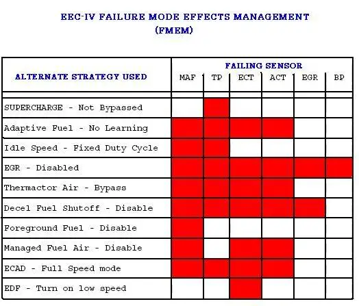

No it doesn't, as explained in the GUFB strategy extract below, the FMEM table shown per sensor circuit failure, and many test cases I've worked over the years that had the EGR disabled (EGR failure codes logged), w/out the owner knowing about it.

I always thought that was true of EEC-V PCMs, because EEC-IV PCMs weren't able to alter fuel trims based on failing components.
You learn something new everyday.
