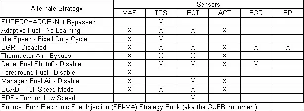

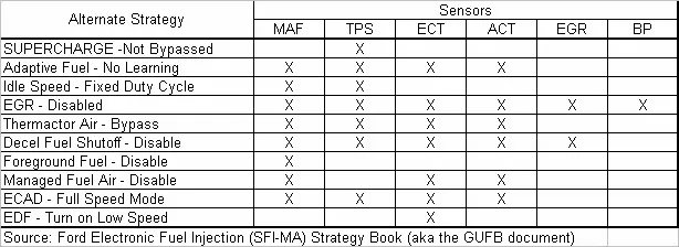

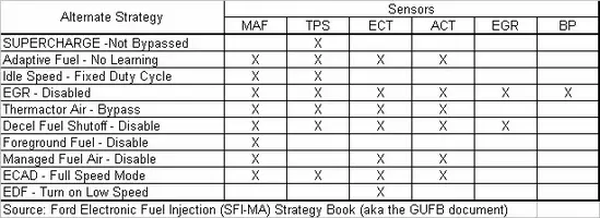

Just for clarification...
If the computer is not getting a feed back signal from the EGR system, then the fuel and timing tables revert to NON-EGR values.
This means that removing the EGR should not cause part throttle detonation, or rich/lean issues of any kind.
here is a table from the GUFB which describes how the computer reacts when a sensors output is out of range...
