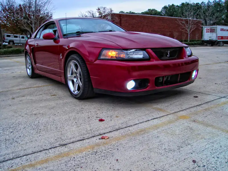

Nonetheless, here is mine with Eibach Pro springs...for me this is a pretty darn good setup, very predictable (I also have full length sub frame connectors, MM K member brace and strut tower brace, UPR upper and lower control arms). I hardly drag race, mostly having fun on the street pushing it into turns...

Your Mach 1 looks great! :nice:
What kind of rims are those, those look really sick man?
What kind of rims are those they look really sick.
