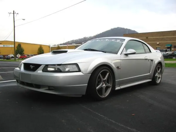

Here's a pic of mine with eibach sportlines. It's actually lower than it looks in this picture, I think it's just the angle I shot it at doesn't show the stance of it very well. Mine settled quite a bit in the days-week. The sportlines will continue to drop a little over time. Mine has settled even further since I put them in a few years back. I will try to get a better shot tommorow. I don't have the isolators in the front of mine either. It actually looks just like VDunn's when you look at it like the angle of his pic.
attachment.php
mine sits at about the same ride height as the red one, and it does kinda seem like the rear has come down just a smidge, but i cant seem to get the damn thing aligned. it had an alignment when i first swapped the springs, but i guess it didnt hold up, or wasnt done correctly. how much do cc plates help in the alignment process?
