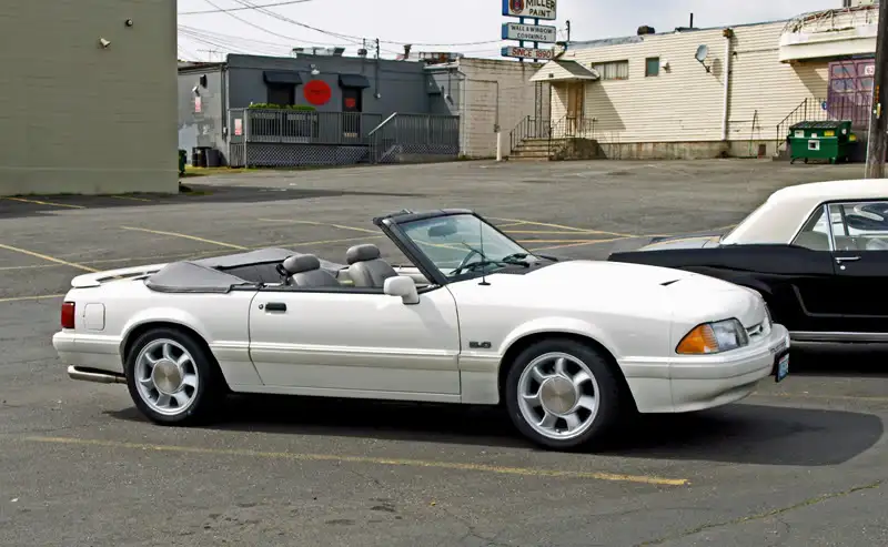

Here is my car with Eibach Prokit springs installed on it.
Nice!
That brings up another point, the year of the Fox, and the isolators used.
New poly isolators can add ~1/4" height over the compressed original rubber isolators.
Also, how people put the spring in the FCA makes a difference. The end of the spring should be aligned between the 2 weep holes. See:
Spring install on a Mustang using the OTC spring tool
For The "B"/Eibach Pro springs, you may not need the OTC tool since the spring is shorter and it's not a "very stiff" spring.
