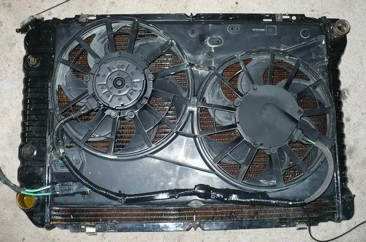

I work in an auto parts store. I tried all the fans, except the Mark VIII, because it wasn't available on the after market, to see what one fit the best.The Contour duel fan covers more of the radiator. Mine cools like crazy. It's been hotter then usual, we have been in the low 90's. My gauge stays right where I want it. I also used a Hayden parts # 3654 fan controller so I could utilize both speeds on the fan. I'm really happy with it.

Here is a picture of the Contour fans mounted to my radiator.
