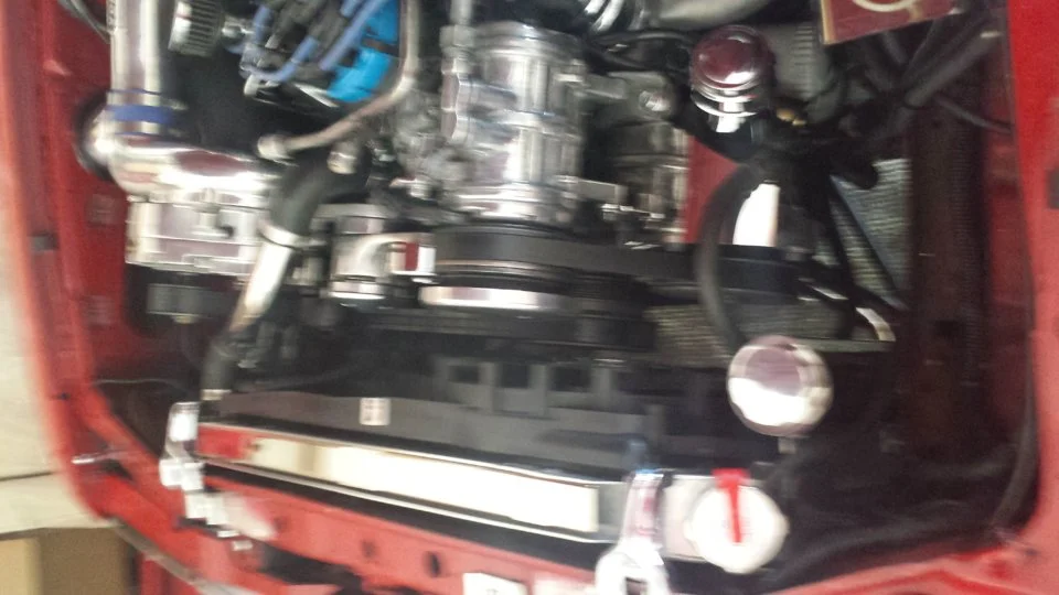

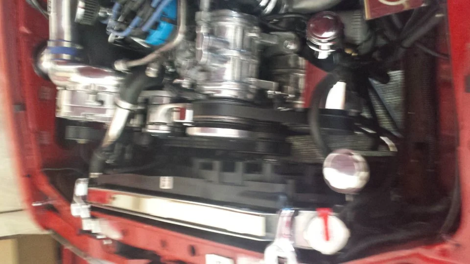

welcome to the dark side Brian. Like you, I tried to get the darn contour fan to fit, but it wouldnt without me hacking up the radiator support.. I ended up getting a Chrysler 300 ( ramcharger 2K) dual fan for $125--- it also is a Dorman 620-039. Fits very nicely on the Fox Radiator and is only 3.5" wide.

What do you figure the clearance is from the end of the crank pulley, to the fan Mike? Looks like it could be around 1/2", but hard to tell?
And do you know the OEM part number Mike? Looks like the fan has changed a little over the years?
i'm running a flex a lite 33054 controller. Sorry I dont have the OEM p/n,,, just the Dorman one posted which you should be able to cross match, I have at least 1/2" between the crank pulley and the fan shroud on an 8 rib setup, a 2 core alum radiator with an a/c condensor and trans cooler mounted in front.
