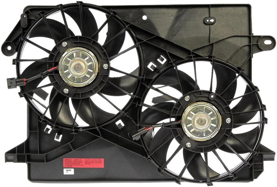

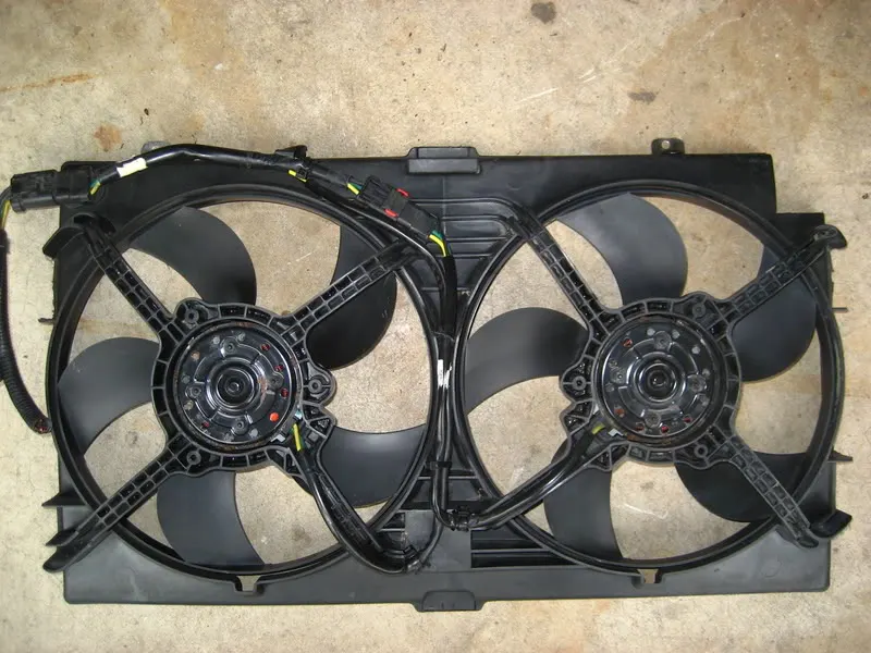

Coming across a discrepinsy Mike. When I look up "Y2K dual Ramcharger fan" set up, the images I'm getting look like this....
....but when I look up the Dorman part number you gave me (620-039), this is the image I get.
Obviously, one of these two isn't the Y2K Ramcharger Fan?
After looking up an old thread, it seems that your is either not a Y2K Ramcharger Fan, or Dorman has changed the configuration?
http://www.stangnet.com/mustang-forums/threads/electric-fan-cooling-in-hot-texas.766414/
well.. now I am confused as well.. my tuner gave me that part number to get.....:shrug:

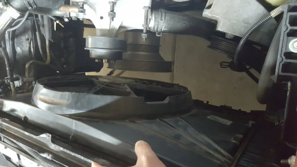

Yeah, I think I'm gonna stick with the dual Contour fan. It's proven, it fits the stock Mustang rad well and I'm already familiar with it.
Found another thread where a guy cleared his 10-rib set up with room to spare, so that's good enough for me. :nice:

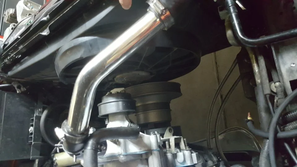

Room to spare is right . I test fitted mine tonight . I should've done this fan to begin with.
