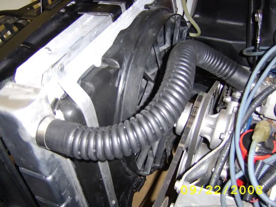

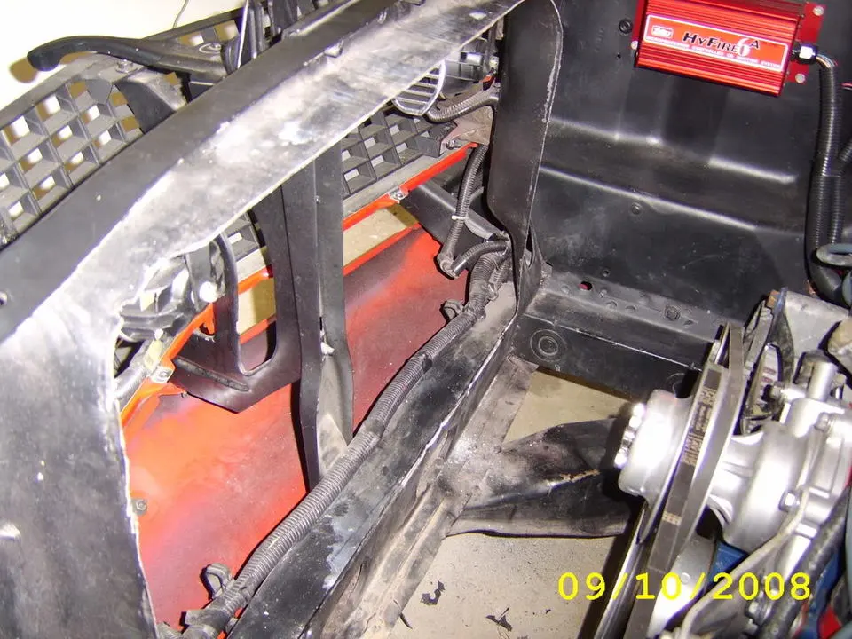

I think I understand...notching it out allowed you to slip that flat mounting flange behind the mounting surface of the rad support, so that the rad actually sticks partway through the rad support, giving it another inch or so...then you shimmed the space up and bolted it down?
I ordered a few days ago the wider 20" 1967 radiator for my 66 coupe, so I'm thinking that if I trim out the rad support, then notch it like you did, I can achieve the same results with a bigger radiator. I've got a mark viii fan which pulls significantly more air, and is almost a perfect match for the wider 67 radiator.

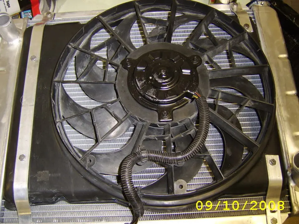

You can trim that taurus fan shroud down a lot also. I also went with the DC controller also. I've had it for 4 years and haven't had any problems with it.

You nailed it.... I was able to move the radiator about 1/2" forward. If your changing the radiator and modifing the support might as well go crossflow and aluminum, I went this route because I didnt have funds to change out the radiator...
