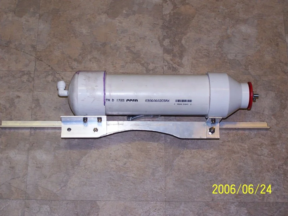

Just a summit overflow bottle with the fittings reversed to make it a recirculating bottle

There is a small vent hole in the bottle. I just opened it up a tad bit more, and then plugged the top port with a an aluminum plug I machined.
Hiehgt doesn't matter because of the way the overflow works. Excess just pushes from the top of the radiator into the bottle. As the system cools, the siphone created draws coolant back into the radiator
