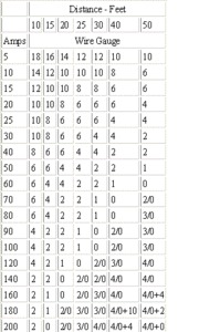

Wire size current table:
53745d1205096904-how-determine-proper-fuse-wire-size-wire-gauge-current-capacity-lenght-chart.gif
Get your power and ground wiring problems corrected before doing anything else. This will save you time and money.
